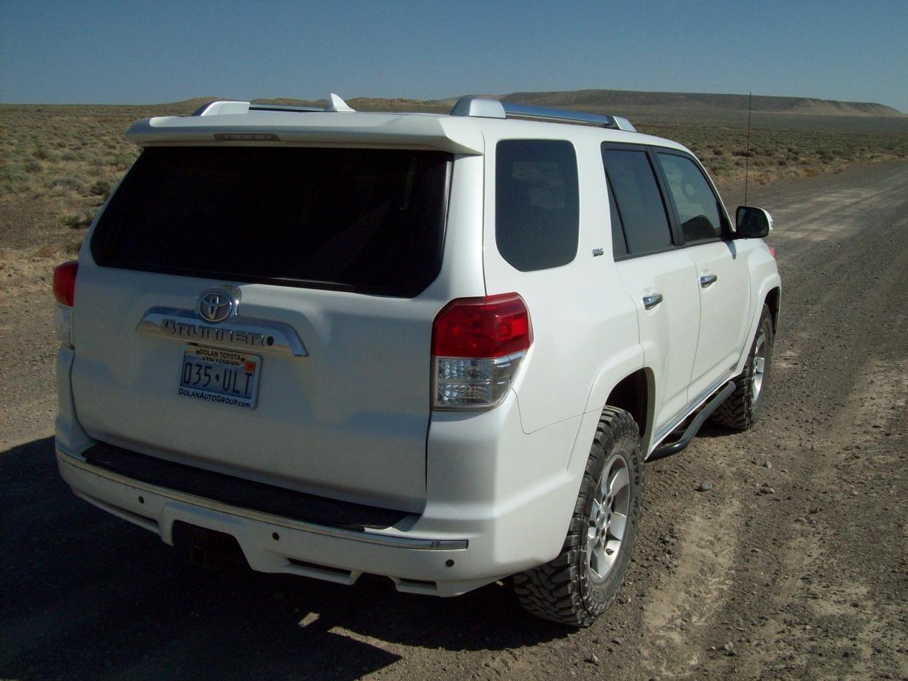

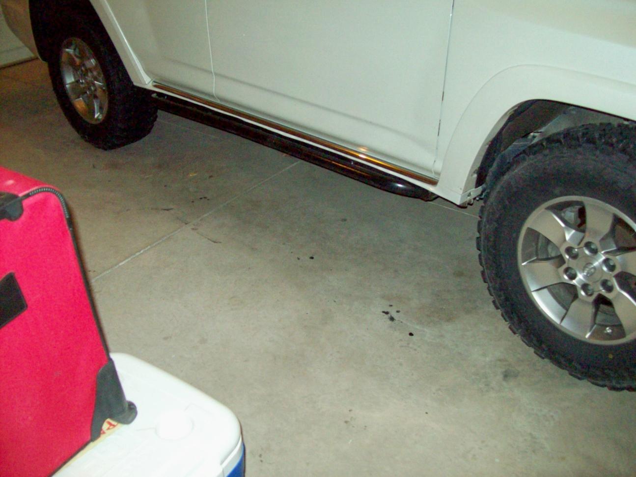

Since I have a 13 SR5 I modified my door sills.

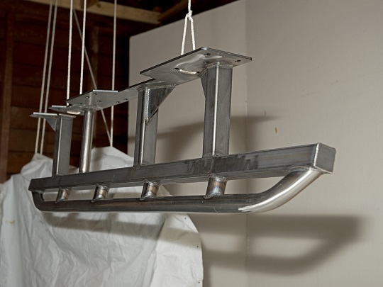

I bought my Domello sliders in bare steel and hand painted them 3 or 4 coats with Rustoelum primer and black. It's pretty tough paint on the trail. I hung the sliders on rope by the mounting holes from the garage rafters so I could paint all sides at once.

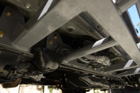

To install them with KDSS lines on the drivers side I used a bunch of wood blocks to support it up close to the frame. Once I got two bolts started it was pretty easy. I've been doing a lot of carpentry work around the house and had the blocks from scraps.
The hardest part for me was removing the KDSS control valve from the frame in order to slide the mounting plates up underneath. There's very little room to turn the one nut that holds the KDSS valve block in place. A ratcheting closed end wrench will make that part easier. There is no room for a socket and ratchet back up there. Look to see how the C4 mounting plate fits around the KDSS before you start and have the right tools ready.View attachment 295252
