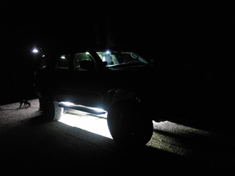

Yes I wired up some cheap lights to my stock wiring reusing the factory plugs. They were cheap and all 4 of them broke within the first couple weeks at the solder joint right at the end of the light. I re-soldered them and added more strain relief and no issues after that.
