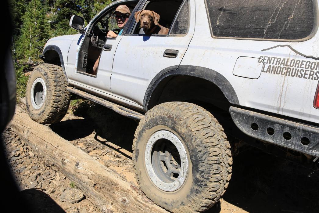

They are not the Shrockworks ones. They are the 67' Trail Gear sliders. Cheap, easy to get, and work. I've had them before and they are tough.
i have mine angled up and tucked close to the body. Could be bad if i slam a rock hard enough but i like the look more and have to imagine it clears more stuff that way.

Mine are nearly flat, maybe a 10-15 degree angle. I have a rear kick out, which stopped me from going any more upwards in angle due to the limited fender flare in the rear. I like the look of angled, but mostly flat gives me a good step that my kids can use to climb up into it. I don't think you can really go wrong with either way.

Mine are at about 7* as well. I have the Stubbs Welding HD-SKO sliders. I used them as a step up. They stick out just enough to be useful as a step. I prefer them to sit a little further out. Often, you might find yourself off camber and, let's say, leaning driver. There is an obstacle on the driver's side. If your slider is tucked way up, it might not give your doors much stand-off room from the driver's side obstacle.
My friend's sliders on his FJ are tucked up there. He managed to hit something hard enough for them to bend a bit and deflect enough to keep his rear quarter door from fully opening.
I angled mine to minimize the chances of slipping through the slider and catching a foot. Depends on the manufacturer, but my friend's girlfriend did that and broke her leg so ya never know.
On the other hand, if you angle them up too much they can contact the body and rattle like crazy on washboard roads. 3rd gens have a ton of body roll so watch out for that as well.
I have had them both ways. Prefer them flat with kickouts as I have found this helps keep things away from my rear quarters, especially when used as a pivot around trees and rocks.
