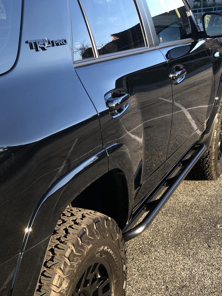

I love my Shrockworks angled up sliders. They sit in close and come up higher due to the angularity. I like that they don’t stand out much. I’m 6’3”, so I don’t use them. My wife is 5’2 and can manipulate using them even with high heels. So can my 6 year old boy. There power coating and quality is great. I did not want a kick out either. I wanted the least noticeable slider out there.
