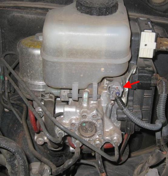

Trevloc,
You could try disconnecting the gray plug in the front of the brake booster assembly to test. That should disable all ABS functions as well as engine suppression, too, I believe.

now are we talking to plug thats next to the steering wheel? orrrr
im not very mechanically inclined...
cosmetics and im your guy, under the hood and i might as well be blind.
Pic is worth a thousand words. Hopefully, yours is similar enough.
so unplug that, and see if problem persists? okay.
i will check that on my way home.
Yes, you won't have VSC or ABS so if it doesn't change anything, plug it back in.
And I should have mentioned it's under the hood, right side, in front of the steering wheel.
