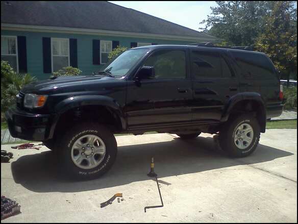

First go 'round with the lift. Bilstein 5100's with stock springs on the highest notch in the front. Freebie LC 7.5 wrap springs with LC Tokico Trekmaster's in the rear. A lot more rake than I wanted..
Ended up getting some Eibach 3" springs for the front, and put the Bilsteins on the bottom notch. Not level, but the rake is significantly less. Still riding on the 275/70/16 BFG's at this time.
