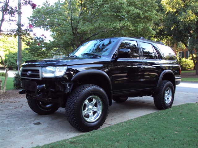

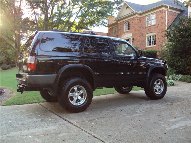

There is a fair gap, but not too terribly bad. The front will likely come down slightly more once the Shrockworks bumper is installed. Here are 2 angles showing what it looks like.

Edit: Will 265/75/16 generally fit at stock hight? they look larger than expected on your rig Obkook! I was under the impression they would have minimal if any rubbing at stock.

What size tire do you have on there now?
Are you planning on getting an ARB or heavy front bumper or just keep it stock?
I have worn out 265/70/16s and they seem to have plenty of spare room. I have no plans to do an aftermarket bumper. The 265/75's should only be 1.3" taller I believe. i don't mind a little BFH'in anyway.
