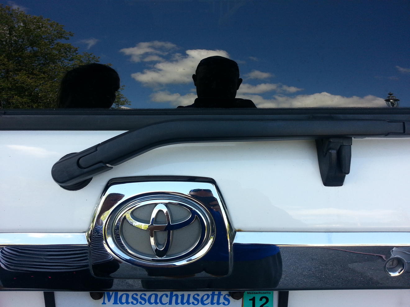

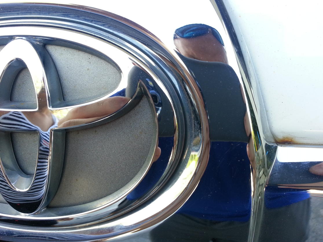

I have a small rust spot (or what it seems like) on the rear hatch (see attached pics)... How can I fix this before it becomes too bad? Do I need to somehow sand in there or scrape it down, or is it possible to fill it in with something?

Looks like the rust goes deeper than it looks. I'ld pull the interior cover off and see what's going on; then I'ld pull that handle off and see what's going on.
Edit: you might also look for rust under the door and window seals.
I agree, it's probably deeper than it looks. If you look at my build thread, I had a similar issue and repaired it.
Thirded that there's probably more. I had some corrosion issues on my hatch, including where yours is. Once the body shop took the moulding off, there was a lot more hidden behind it that all needed sanding, anti corrosive primer and a proper paint job. I'm not sure what year you are, but there is a TSB for certain 4th gens and it should be covered under the 3/36 bumper to bumper warranty.
No. Mine wasn't covered. It's an '07 and I just had it fixed last year. Fortunately I know a good body man, so I paid next to nothing to have it done.
I paid cash for mine and also got some other work done. In MA, depending on where you are, expect to pay around $450. They will need to strip the gate (moulding, glass surround, third brake light, wiper), put on new emblems, and clear coat the whole thing.
