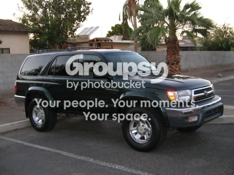

Back in September 2008 I sold my 96 4runner with about 197,xxx miles on the clock and picked up a 2000 4runner with about 94,xxx miles on it.
When I bought her:
2000 Toyota 4runner, auto 4x4 w/ elocker and sunroof, 94,xxx miles. The suspension was shot and the tires were crap (probable the 2nd set of tires on it, front passenger side tire blew out due to the crappie tires)
Next to the old 4runner:
IMG_1522.jpg~original
IMG_1526.jpg~original
First minor change (tires and suspension, 265/75/16 Yokohama Geolander AT's and Sonoran Steel 7.2 lift :) )

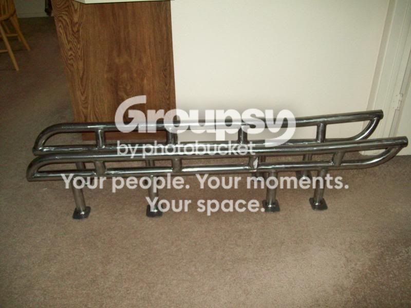

Stubb's HD-SKO, got to protect the rocker panels while out in and bout exploring:

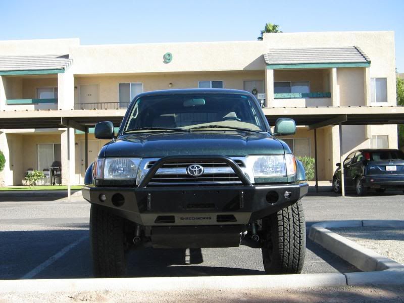

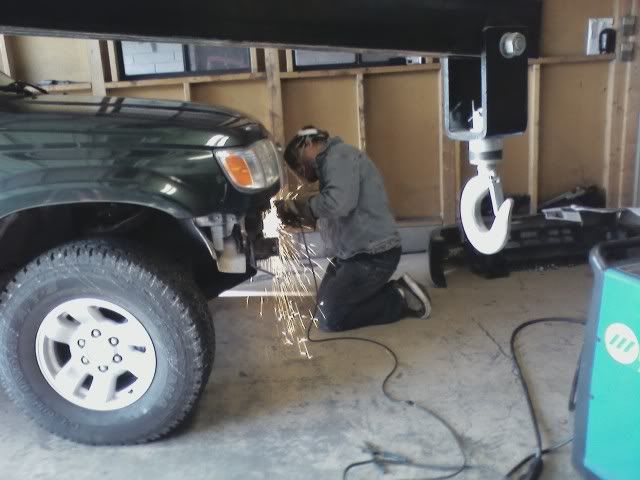

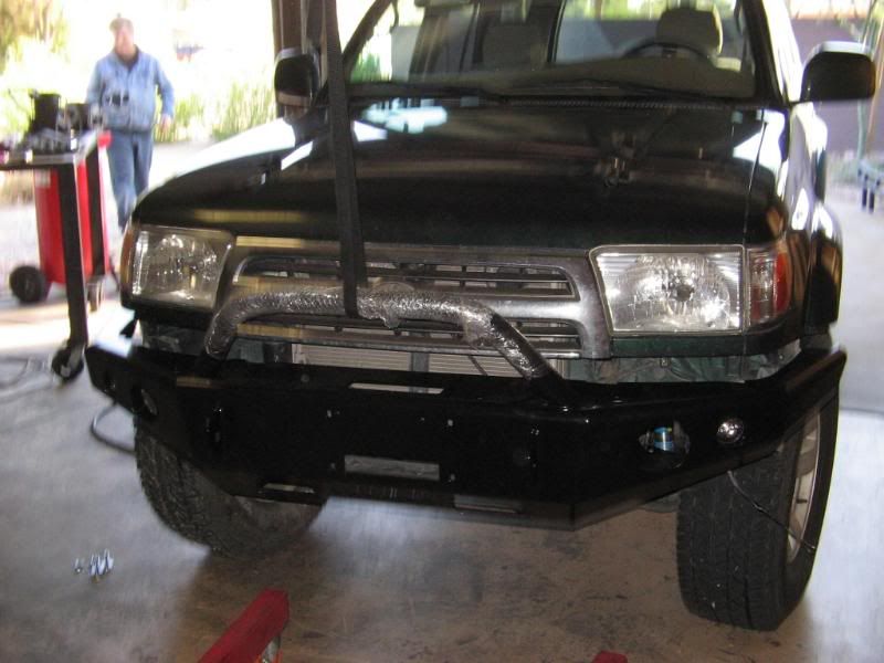

Bumper and sliders install plus the drama of it all

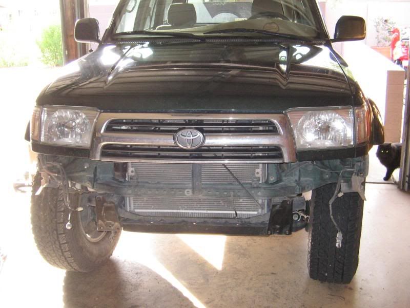

Off with the old and on with the new (one benefit of living in Arizona was the Steve Schaffer for Sonoran Steel was close by):
1220081307.jpg~original
IMG_1780.jpg~original
http://img.photobucket.com/albums/v681/tbox/Bumper/IMG_1781.jpg[/IMG

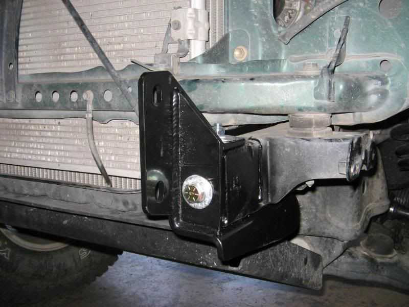

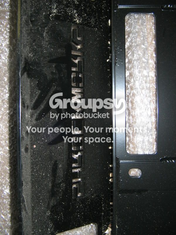

New endcaps and bumper brackets:
[IMG]http://img.photobucket.com/albums/v681/tbox/Bumper/IMG_1782.jpg~original
IMG_1783.jpg~original

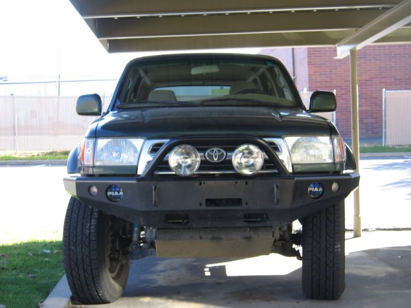

Going into place and the final prodcut
IMG_1784.jpg~original
IMG_1786.jpg~original
IMG_1787.jpg~original

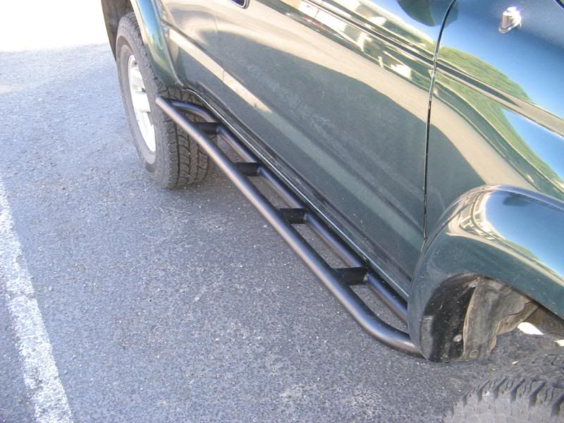

The last item Stubbs HD-SKO Sliders
IMG_1789.jpg~original
Took about 7hrs. from start to finish which doesn't include the 2hr wait to have the electric company fix the power line.
Overall, the Shrockworks bumper is awesome but a pain in the butt to install. We spent about an hour alone trying to get the bumper aligned up with the brackets. Ultimately, we had to spread the brackets apart, grease them up and grind the powercoat off to get the bumper to fit properly. It will suck way downline when I get a winch and we have to take the whole thing off again. Good thing that ain't happening for awhile.

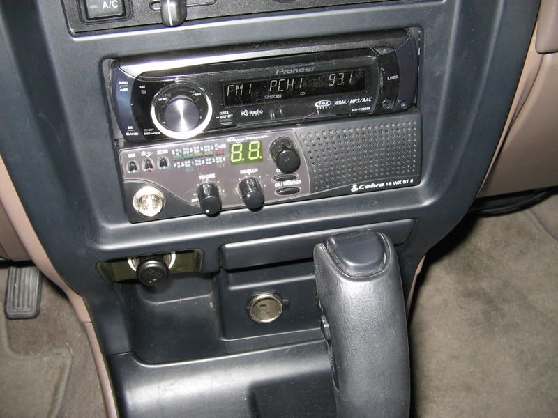

CB Install
Reinstalled the CB out of my old 4runner and picked up a new headunit since the stock radio's volume knob was broke.

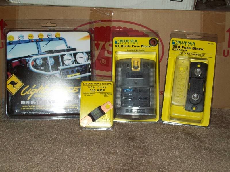

Shortly after installing the PIAA's I picked up a set of Lightforce 170's from Wil at Sierra Expeditions as a few other goodies from Marine Technology.
Blue Sea 5025 ATO Fuse Block, 6-Circuit with Cover and Negative Bus
Blue Sea 5001 SEA Mega Fuse Block
Blue Sea Mega SEA Fuses 100A-300A (ordered a 100amp fuse, fiqured that be enough).
OEM Toyota Foglight Switch
100_1207.jpg~original

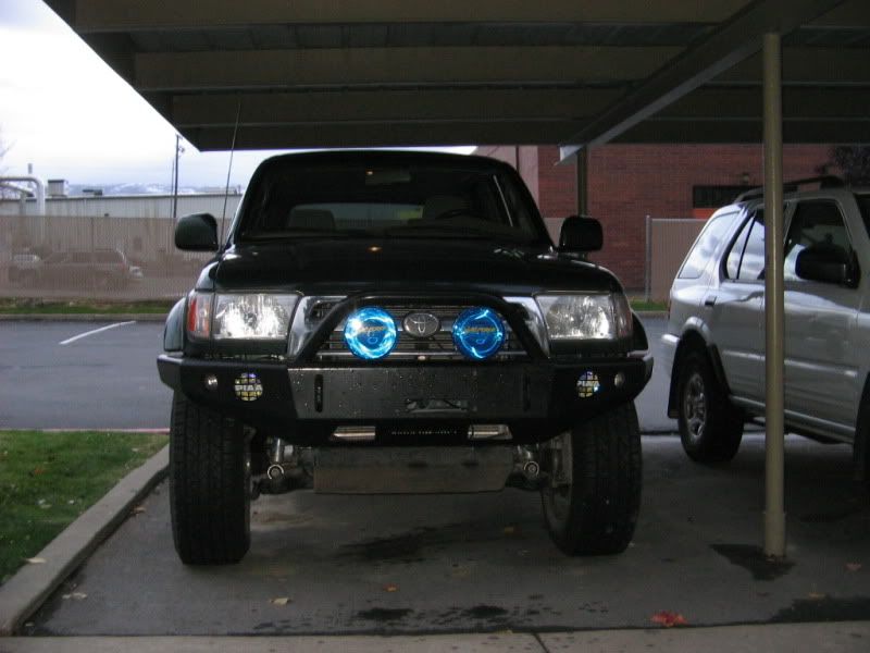

Fuse Block and Light Install:

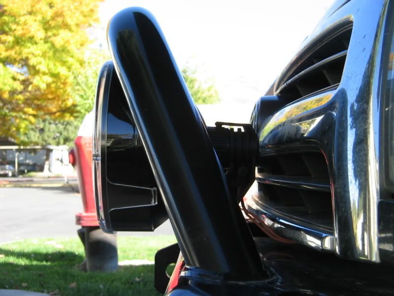

1. For those 3rd gen 4runner owners with the Shrockworks bumper. If you decide to get a set of Lightforce 170 lights they will not fit in the holes provide by Shrockworks. You have to drill new holes about 1-1/2" over from the exiting holes and request the low light mounts. Otherwise the lights will be too tall by roughly 1/4 - 3/8". Thanks to Wil for the new mounts.
2. My mounting setup is for the Shrockworks bumper with the single hoop.
3. I reversed the lights mounts so no modification was required to the grill (have about a 3/8 -1/2" clearance).
4. The wiring hook up for the lights suck!!! The crappie connectors they supply you with in the wiring kit are junk (IMO). I ended up destory two of them.
5. Thanks to Johnny Lange of the Wasatch Cruisers for helping to mount the aux fuse block and fuse.
Okay, so here are the pictures after that little rant/soap box :sombrero:. Pardon the dirty battery. I still need to do some clean-up.

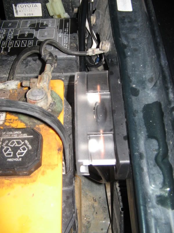

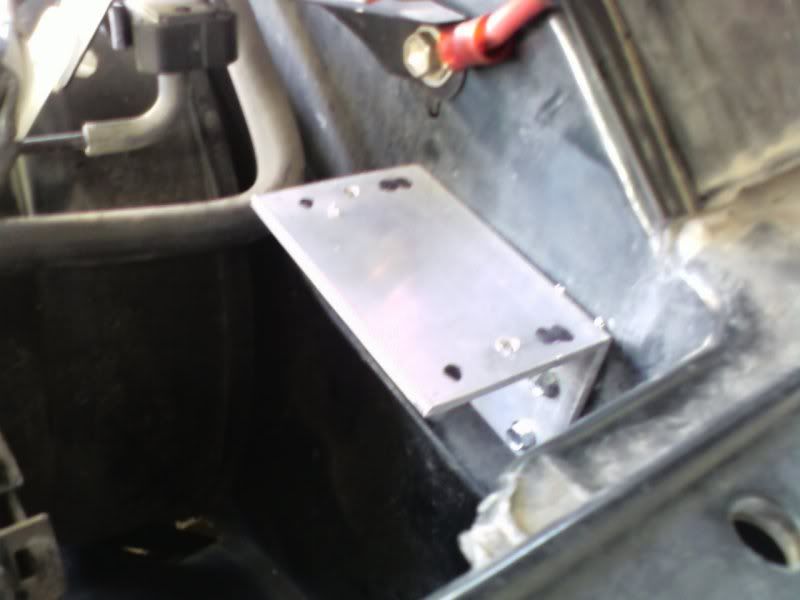

Aux fuse block mounting bracket (see #5). Kind of took us awhile to fiqure out where to mount the block since there are not that many good places in the 4runner's engine bay to mount it too.
1025091305.jpg~original
Aux. Fuse
IMG_0107.jpg~original

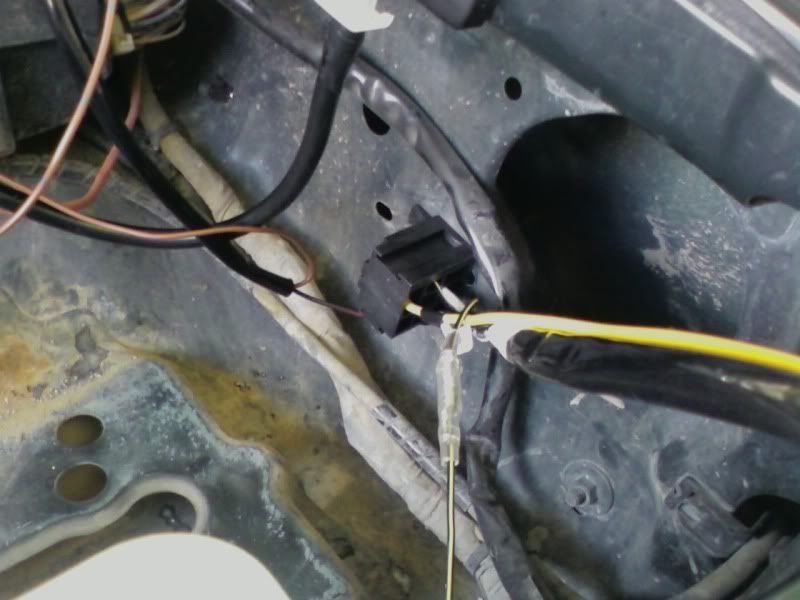

Since I already have a set of PIAA fog lights installed I had to fiqure out a new mounting location of the lightforce relays. The best solution I could come up with was to mount it where the control for my DRL's was. Since I already disconnected them prior to this in seemed like a good place.
Where the module used too be:
1025091328.jpg~original
Relay installed
1025091336.jpg~original

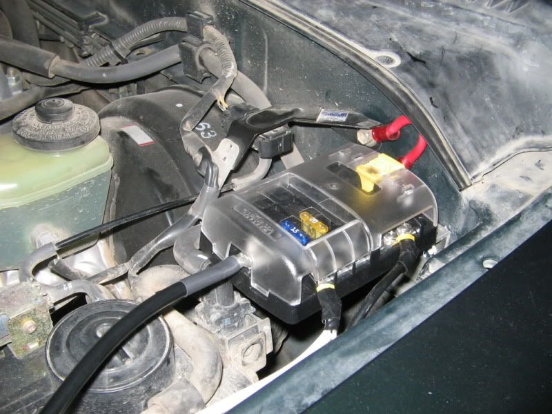

I ended up mounting the inline fuse to the bolt/location that I have the relay for my other lights installed. By the way the mounting hole in the inline fuse is a little small. All of the wiring I tried to run along the left side fender under some of the hose's which made for some fun times.
Aux. fuse block all buttoned up.

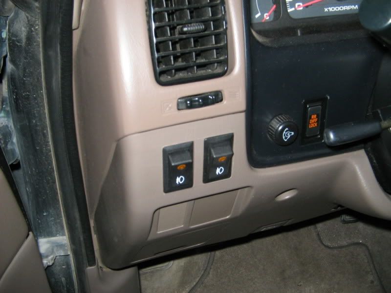

The stock switch proivded with the wiring kit again sucks but that's my opinion so I picked up another factory switch. Only thing I have to do is run a ground wire so it will light up.
IMG_0102.jpg~original
The finished product
IMG_01031.jpg~original
The clearance issue I mentioned in #3 and 5 above. The lights sit pretty flush/inline with the front of the hoop.
IMG_0104.jpg~original
All lite up (this was the only to come out decent since my camera doesn't take very good night time photo's)
IMG_0112.jpg~original

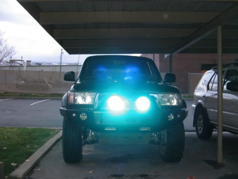

Well, another little item I picked up when I bought the lights were the Blue colored lens. I thought they would be a good investment for the winter time up here in Utah. You know for when I want to go play in the snow. :victory:
Any who these are the Combo lenses - pencil beam with a wide beam. The clear covers aren't that great in the snow since thye produce a little too much glare. Tried that out this morning on my way to work.
So I went out tonight to Canyon Creek (just a short little trail)to see how they looked and truth be told I had a blast with them.
That which is blue:
IMG_0117.jpg~original
IMG_0118.jpg~original
Without the flash on:
IMG_0132.jpg~original
Headlights alone -
IMG_0140.jpg~original
Lightforce light with my Piaa fog lights turned on -
IMG_0139.jpg~original
Lightforce by themselves -
IMG_0141.jpg~original
It was interesting trying out the lights with different settings

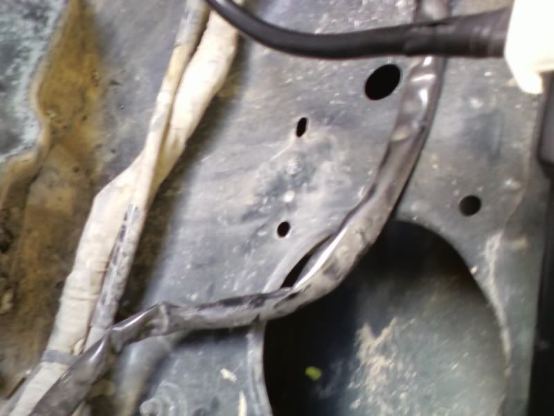

Not pictured is the Tacoma whip antenna install. A couple of trees and a car wash ended the life of the power antenna. I swear you have to be 'Gumby' to see where that bloody wire runs inside the cab.

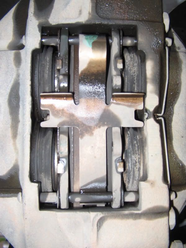

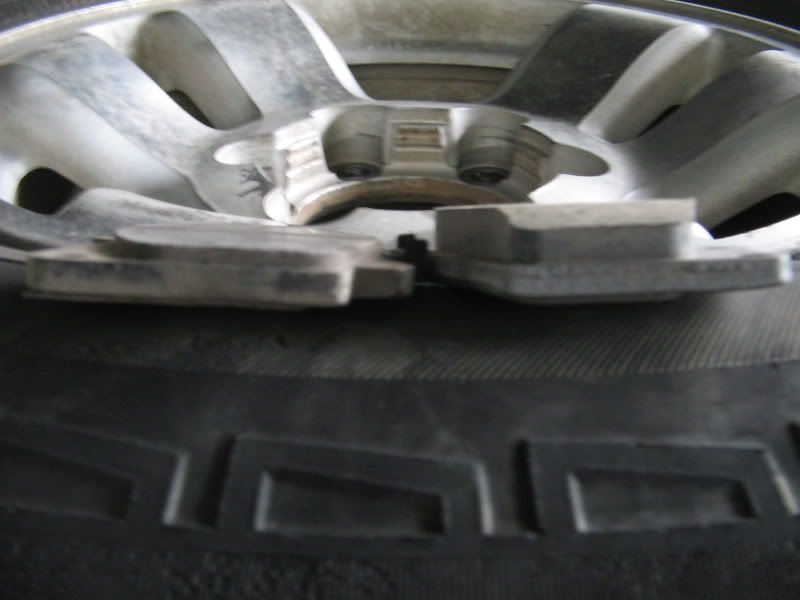

Not really a mod just some much needed mainteance and the first time doing brakes in 5 years.
All I got to say is thank you Toyota for making the pads on the 4runner so easy to change out. :victory:
IMG_0018.jpg~original
Um, should've changed these pads out a while ago
IMG_0021.jpg~original
IMG_0022-1.jpg~original

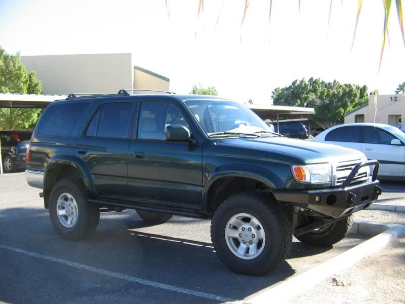

How the 4runner sits today, just not as dirty (in the coming months some other changes will be taking place :thumb3:).
100_4314.jpg~original

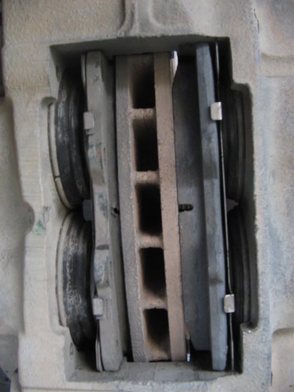

looks like you got some uneven wear from your caliper on that one.
if the next batch does the same thing you might want to consider the Tundra upgrade if only to upgrade the calipers.
basically, the uneven wear cost you a bit by having you do a pad change before you shoulda had to. that one pad on the right has a TON of wear left on it.
Guess I should've clarified the brake pad thing some.
Picture 1 - old pads in the caliper
Picture 2 - old pad vs. new pad
Picture 3 - old pad vs. new pad in the caliper
