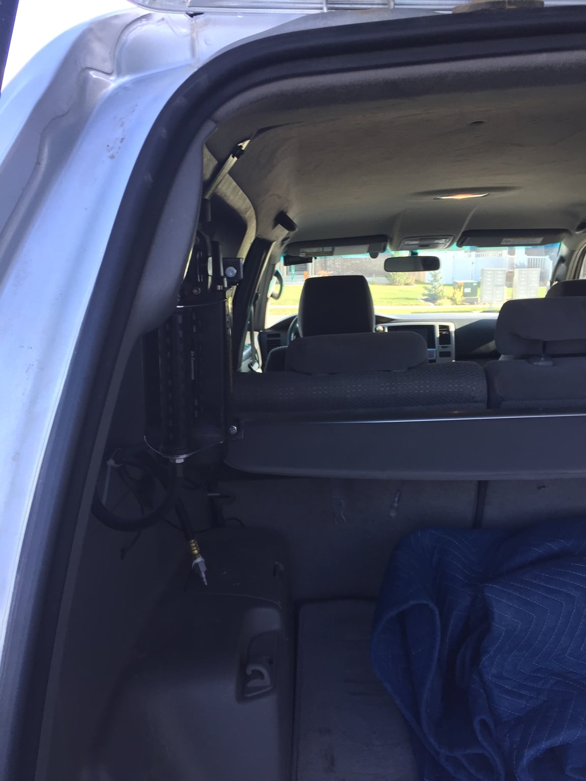

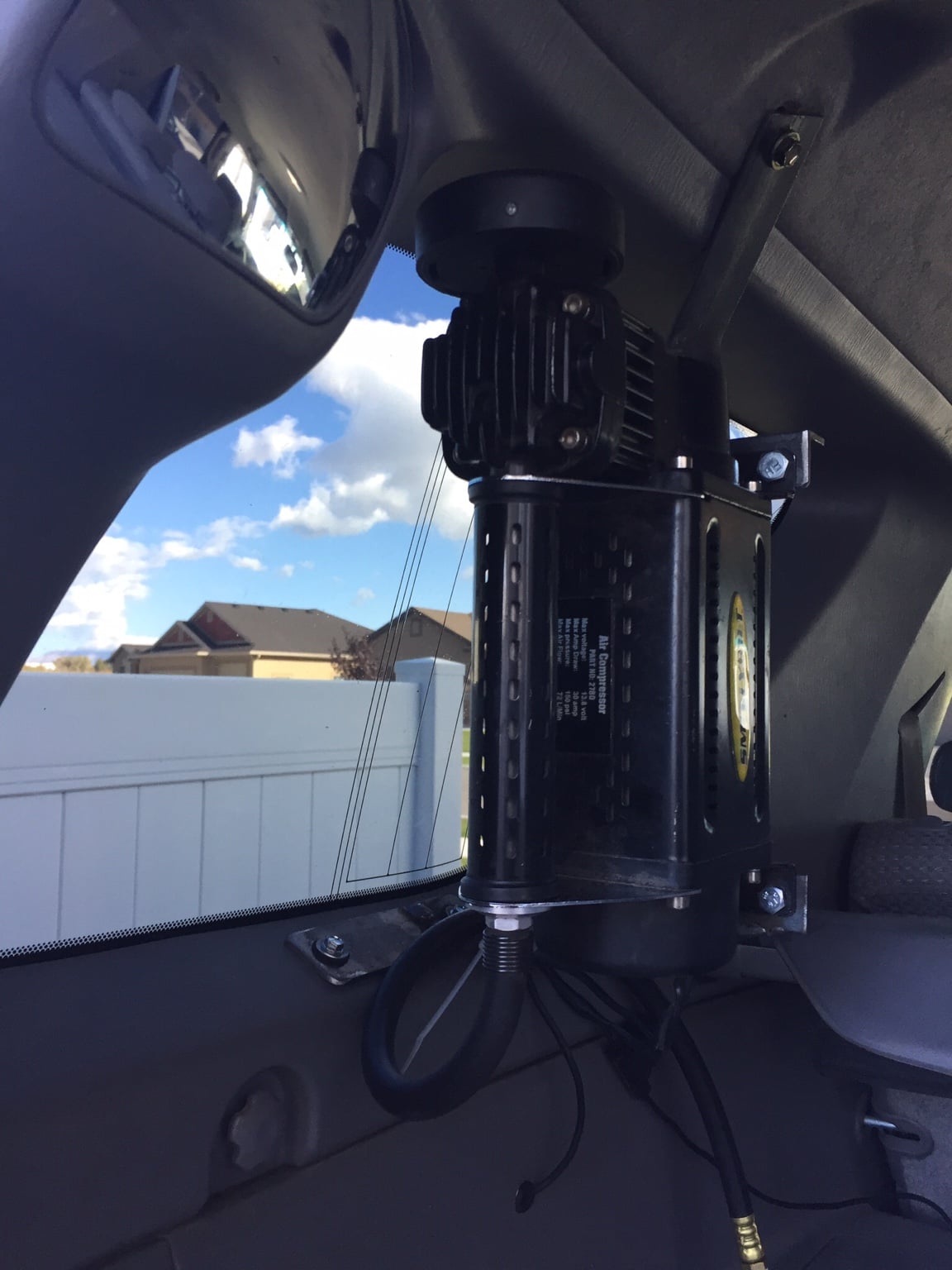

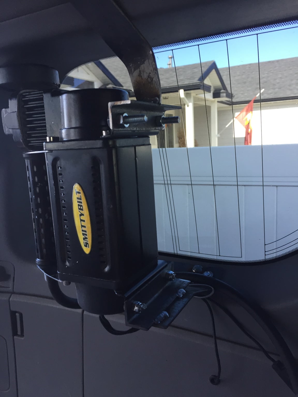

Got tired of moving it around all the time, and didn't want to put it under the hood it gets damn hot filling up tires, and I don't want it getting all dirty and nasty under there. Here the switch is accessible, and I can fill up my air helpers quicker.
Made from 1/8 steel. Upper bolt is in the hook bolt spot, two lower screws go into some internal bracing. You can pull on it pretty damn hard and it doesn't move. Going to pull it out and paint it. Maybe wrap in foam too.
At least one of my 3rd row passengers would be unhappy with that location, but I applaud your creativity and OFTB thinking.
