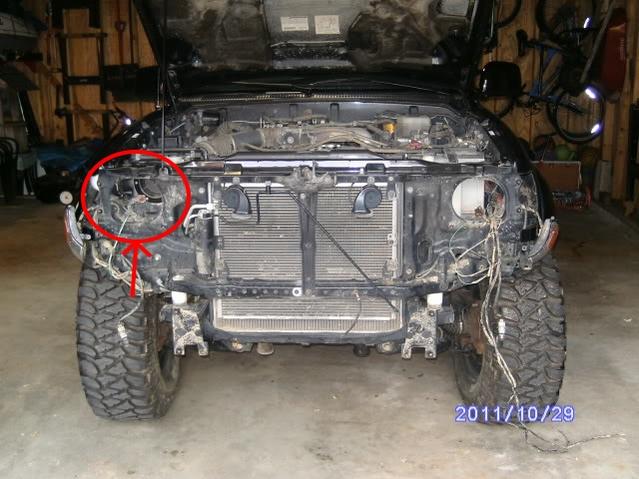

As stated above, there's no such thing as a "no cut" snorkel. You could pop the passenger side headlight out and put a pipe straight up from the front?
Borrowing a pic from Bandit Runner....
