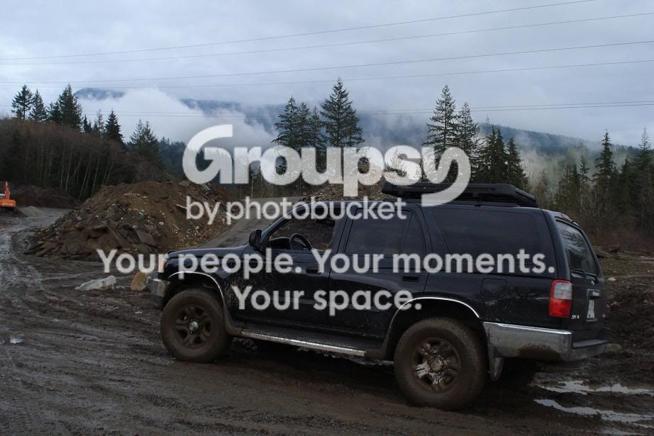

Went mudding sporting my newly acquired 02 wheels and tires, chrome sidesteps and roof rack my brothers gave me...really nice to have brothers who both owns 3rd gens too. Deep mud was when I had full use of the RR Diff Lockers.

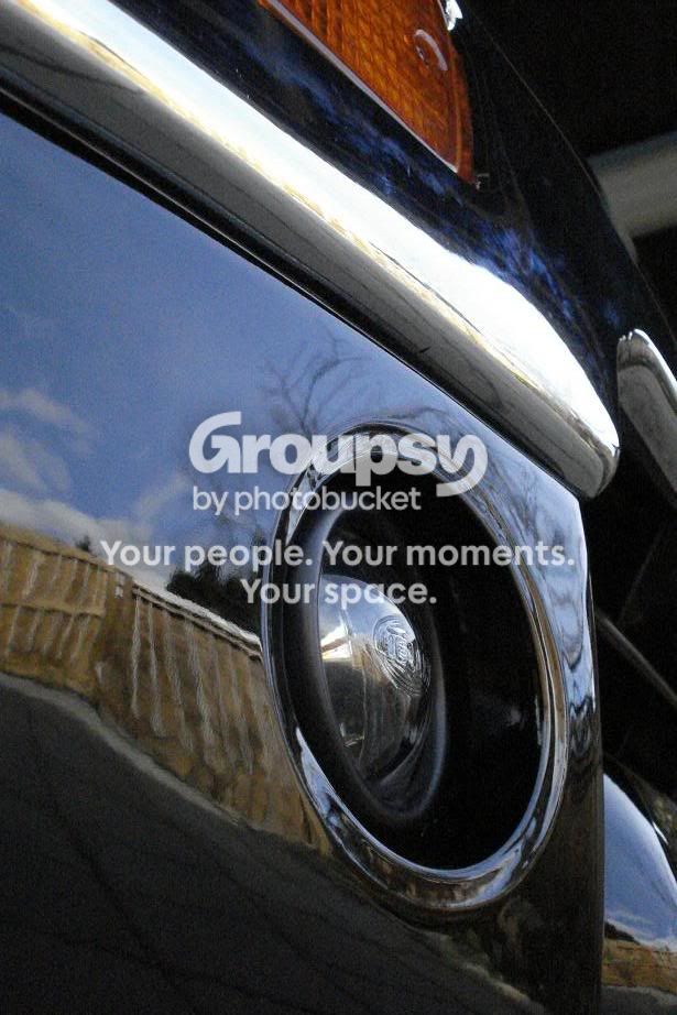

Modified my lower valance to accomodate my Hella Micro De Xenons..Got it painted to match the body color..also changed my grill to a 01-02 version.

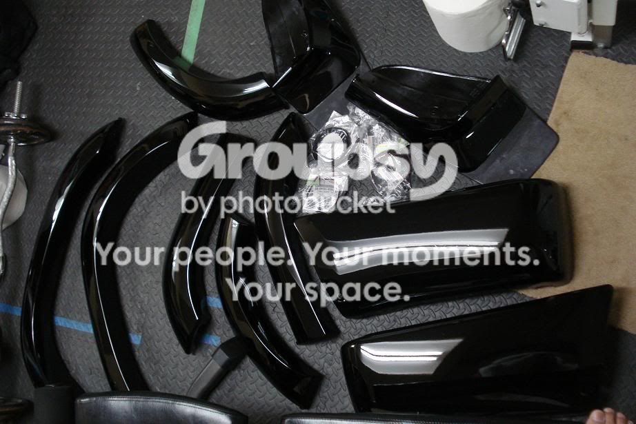

I planned on using 33" tires plus the Spidertrax 1.25" spacers, and I knew If i went that route I'd have to find a set of fender flares that gives better wheel coverage that a Sport, SR5 and Limited models only offers. Finding a set of SR5 flares wasn't easy but in return I gained a friend in the process.
here's my SR5 fender flares..courtesy of a good friend(Ron) from Denver Metro...
Dry-fitting on my '97.
here are my fenders filled with holes I made to accept the push-in clips I bought at a local parts store..Not even 2 of the body shops I took the flares to, said it'd be impossible to mount 'em up using the clips and without the actual template...I took it as a challenge. As I have no real template to use to mark the locations of the holes, I had to improvise and use the 'paint transfer" method. Did it twice for each fender and they matched. I used rust inhibitor for the drilled holes..

clips I used to secure the flares...in addition to the clips I used "gloozit"..an automotive adhesive and sealant..it dries hard yet remains flexible...very good product.
had the flares' scratches repaired then painted..even my rear bumpers..I also ordered the rubber gasket from Toyota...matching black.
time to see if the holes I drilled on my fenders lined up...
it's as if my truck came with them to begin with.

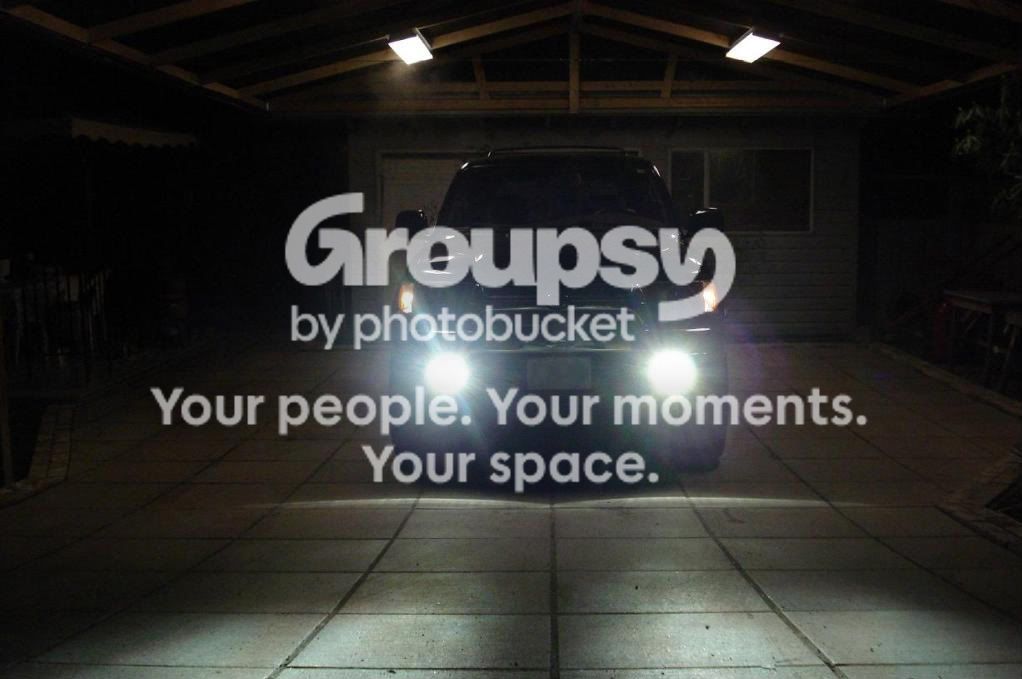

I have a set of PIAA 520's sitting in the closet(another freebie from my brother) ones that I've always wanted to mount on my bumper but having the 01-02 grill presented a set back as it sticks further out compared to my stock 97 ones, let alone the fact that 97's have short bumper...there was nowhere to mount the lights onto..So I resorted back to using the original 97 grill..While I'm at it I thought of doin' the Satoshi mod thinking It'll give me more room so the lights don't stick out...so I did...
I went the extra mile and modify my chrome grill to better flush fit the lights, fab up a bracket in front of the rad to hold the lights secure.

It's actually LINY4Runner who I asked how he mounted the flares, and he suggested the use of FIPG--very similar to what i used, but for extra security, I used the push-in clips, he said he wouldn't recommend drilling holes unless you're confident in what you're doin. Two of the body shops I took the flares to, said it would be impossible to mount 'em up using just the clips without the actual template...I took it as a challenge.
