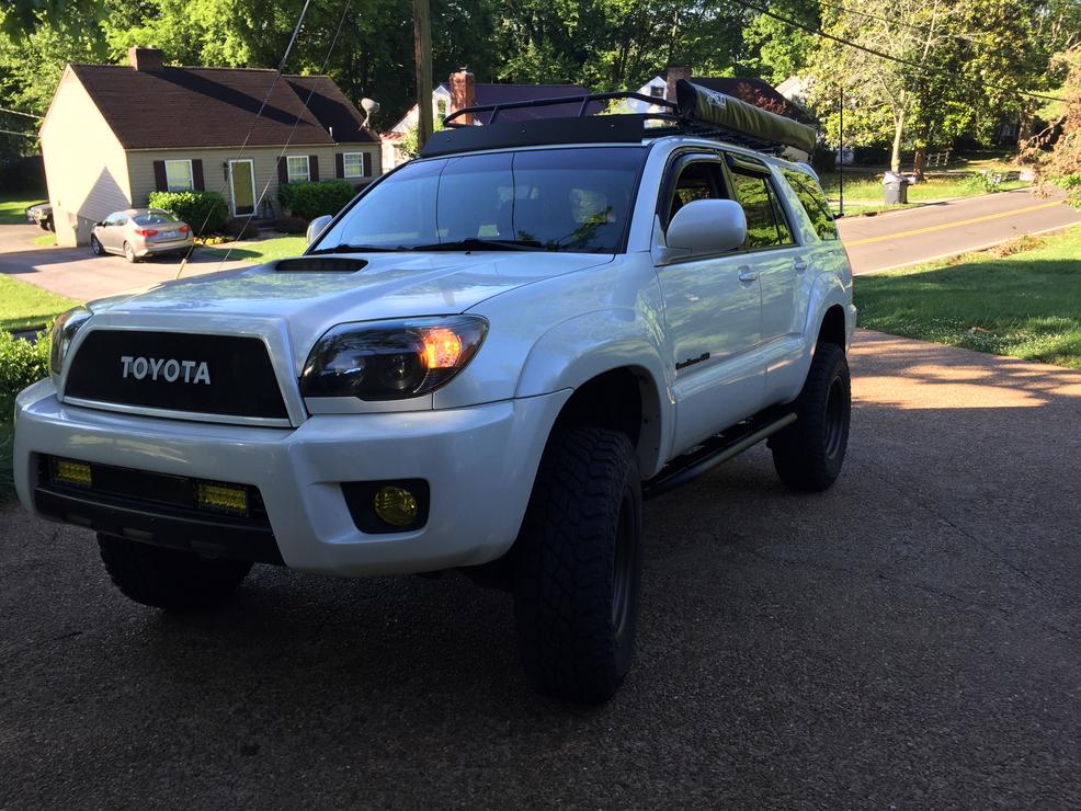

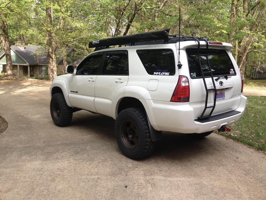

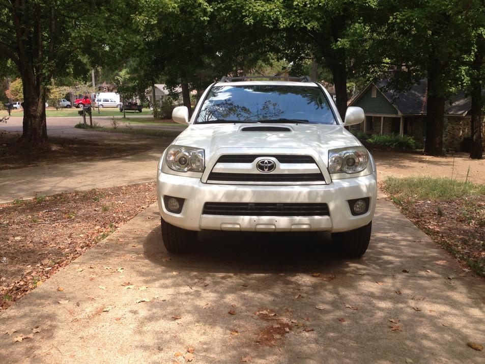

Pictures below are my current set up, and when I bought her bone-stock. There are also other things I've forgotten to list, and more to come, so stay tuned!

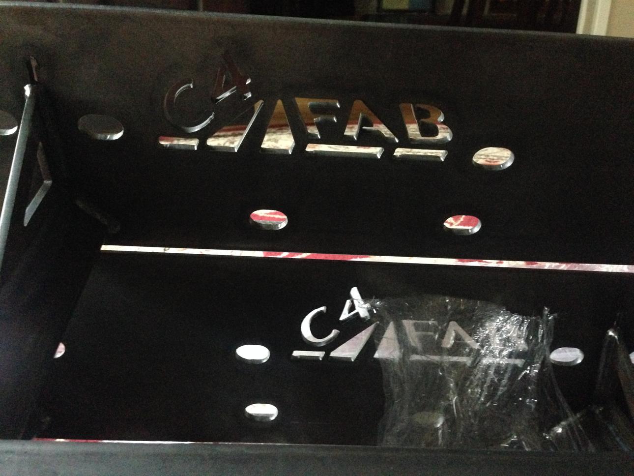

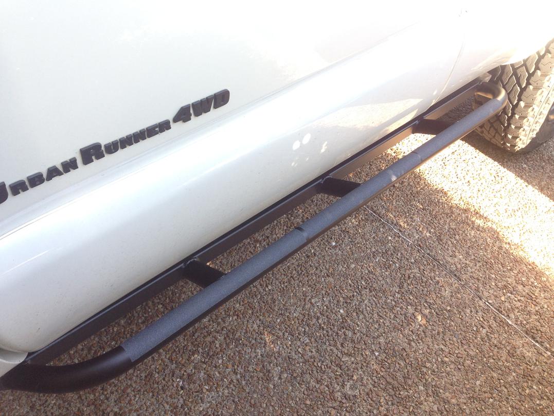

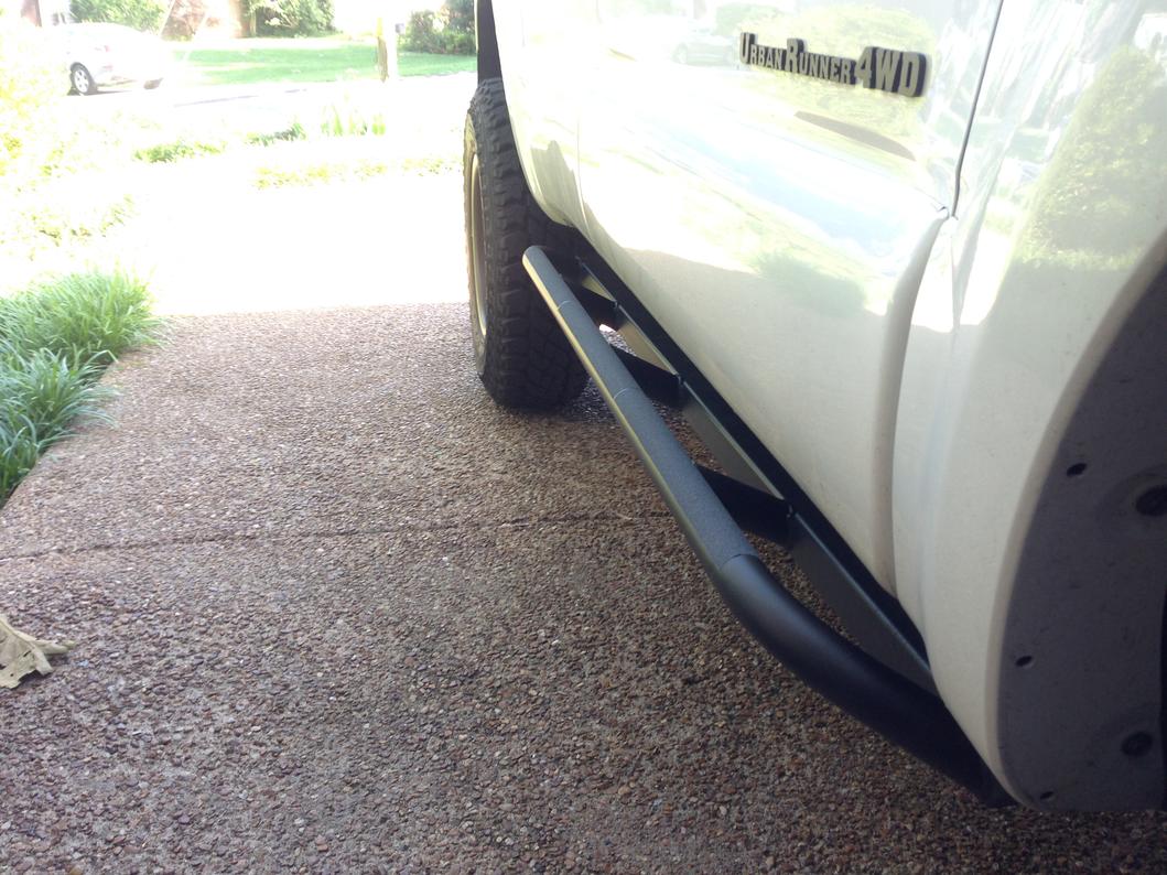

C4 Sliders sand blasted, PC'd (textured black), and grip taped. Install: done. Pretty pleased with the results :artist2:

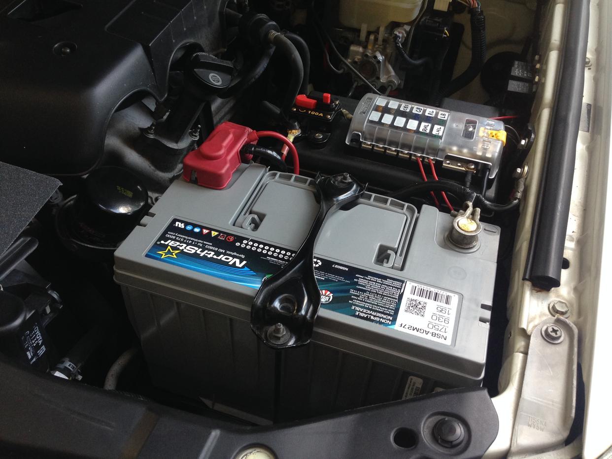

Also got her some fresh juice. Loving the larger 27F. Nearly 1000 CCAs :eek:

Luke... look at these sliders... love the look!
Thanks! They work great so far. Just need to put them to the test on a trail somewhere
