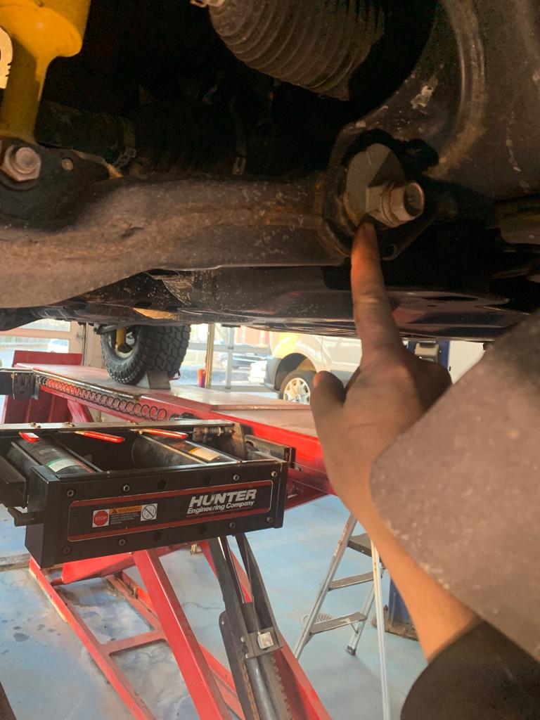

Evening all. Posted this somewhere else, but like everyone’s 2cents. I need a new passenger side LCA. Probably should replace both. Wasn’t expecting this but when we want to align my new 285s, the eccentric was seized to the bushing sleeve resulting in not being able to completely get the Alignment right. With that being said, I need a new LCA. I think. Any suggestions? I don’t need anything crazy like a dirt king, etc. something comparable to the Stock oem LCAs. I don’t want to pay a shit ton either. Or is it something where I can somehow get the bolts out to replace. Or somehow loosen to finish the alignment. I have a 2016 Trail non KDSS. Working with Dobinson UCAs and 285 70-17s.

Thanks everyone. This was a huge help. So I spoke with my shop buddy. We aren’t going to replace the arm. Way to expensive for a non broken part. We will order the bolt and bushings, etc. try to remove without breaking the bushing. If all else, cut the bolt and then replace the bushing and bolt. And walllla. I hope. To be continued unless anyone else has something to add.
