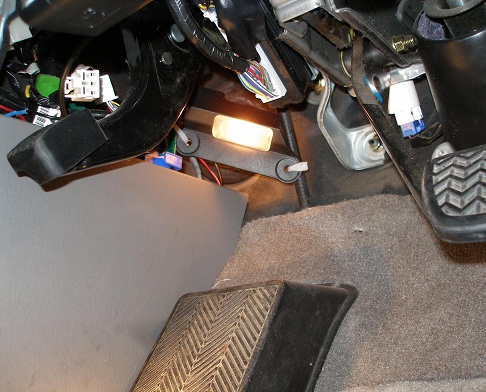

Hey guys... I added footwell lighting a couple years ago and love them! It's actually one of my favorite mods. However, I recently upgraded to LEDs all around, so now it looks odd having my footwell light (driver's only is not LED now) with the ugly incandescant glow.
What I'm hoping is that the rest of you who have also done this mod, whether or not you added LEDs or not, can share some pics of how you did it to give the rest of us (me) ideas :)
Thanks!
Here's mine

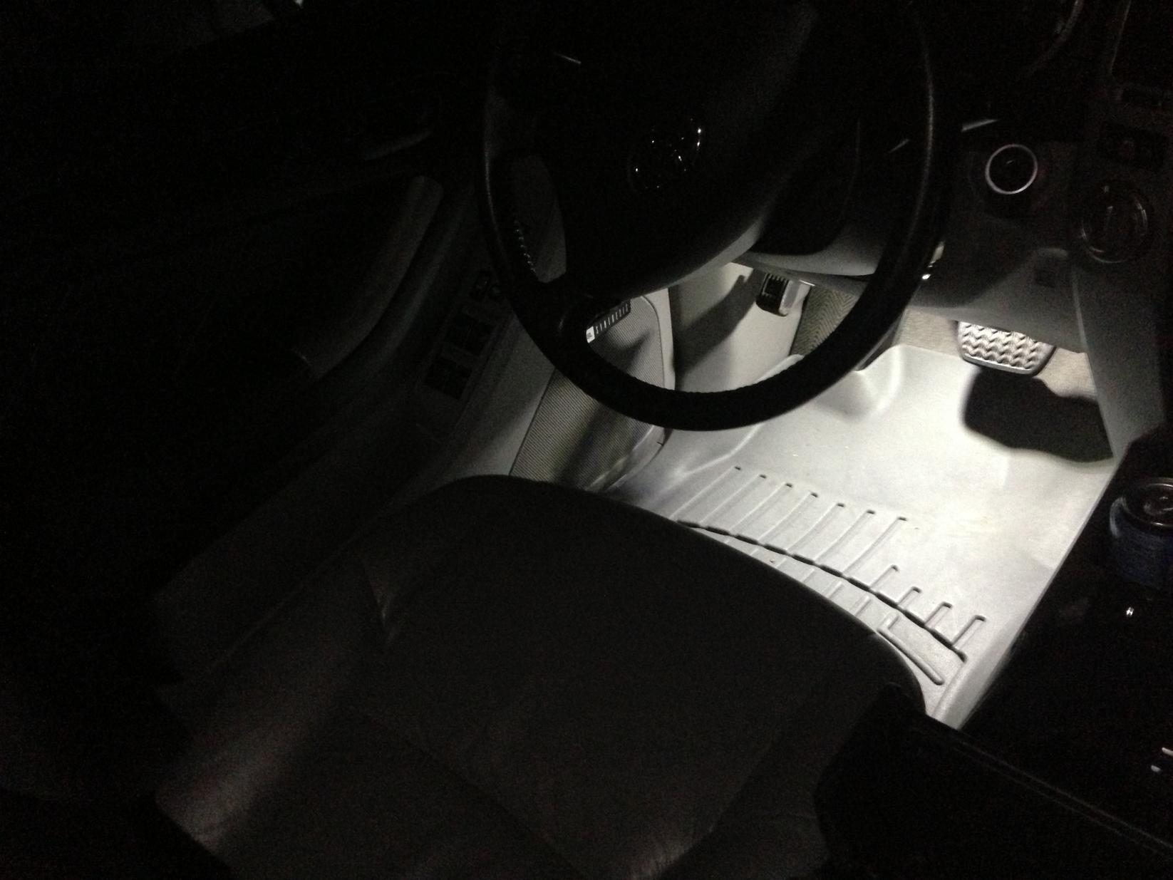

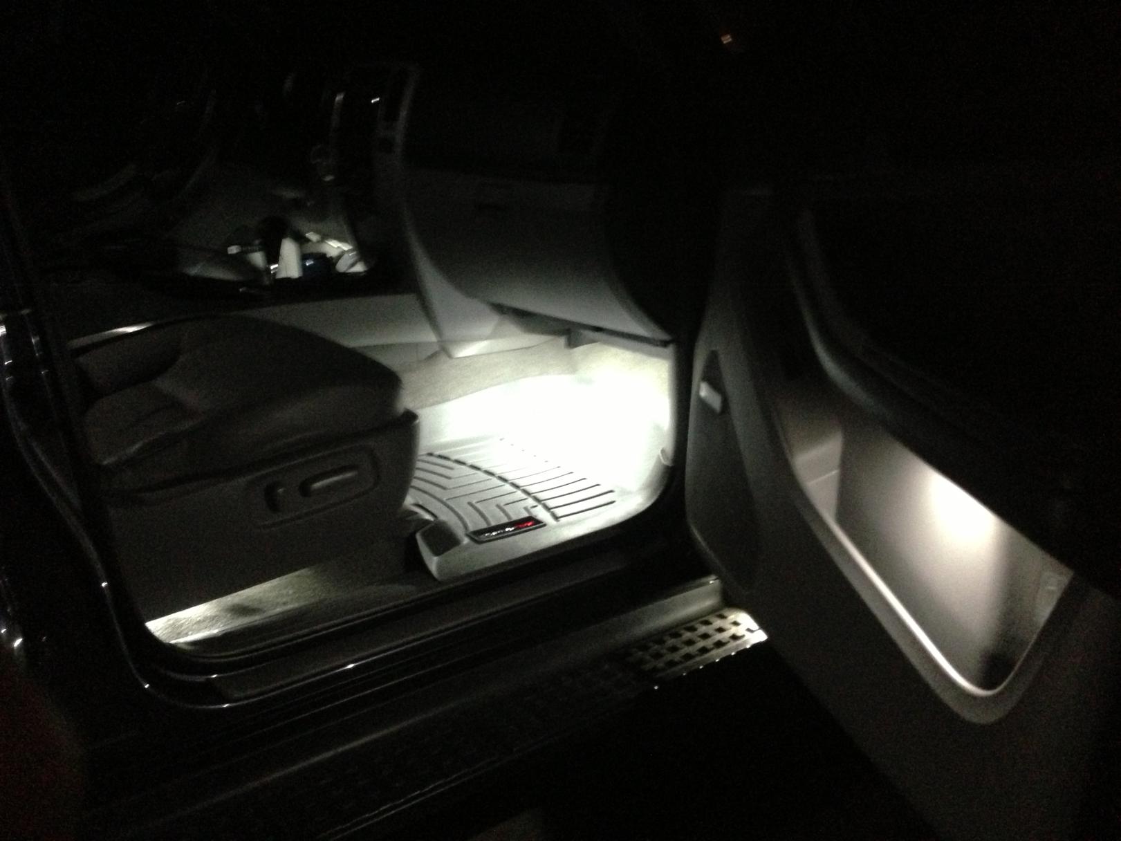

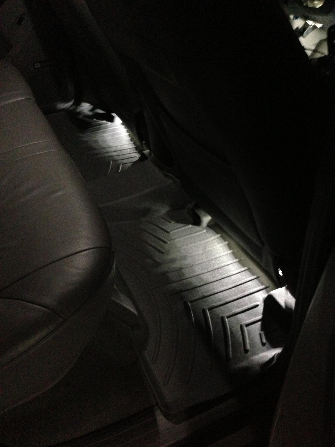

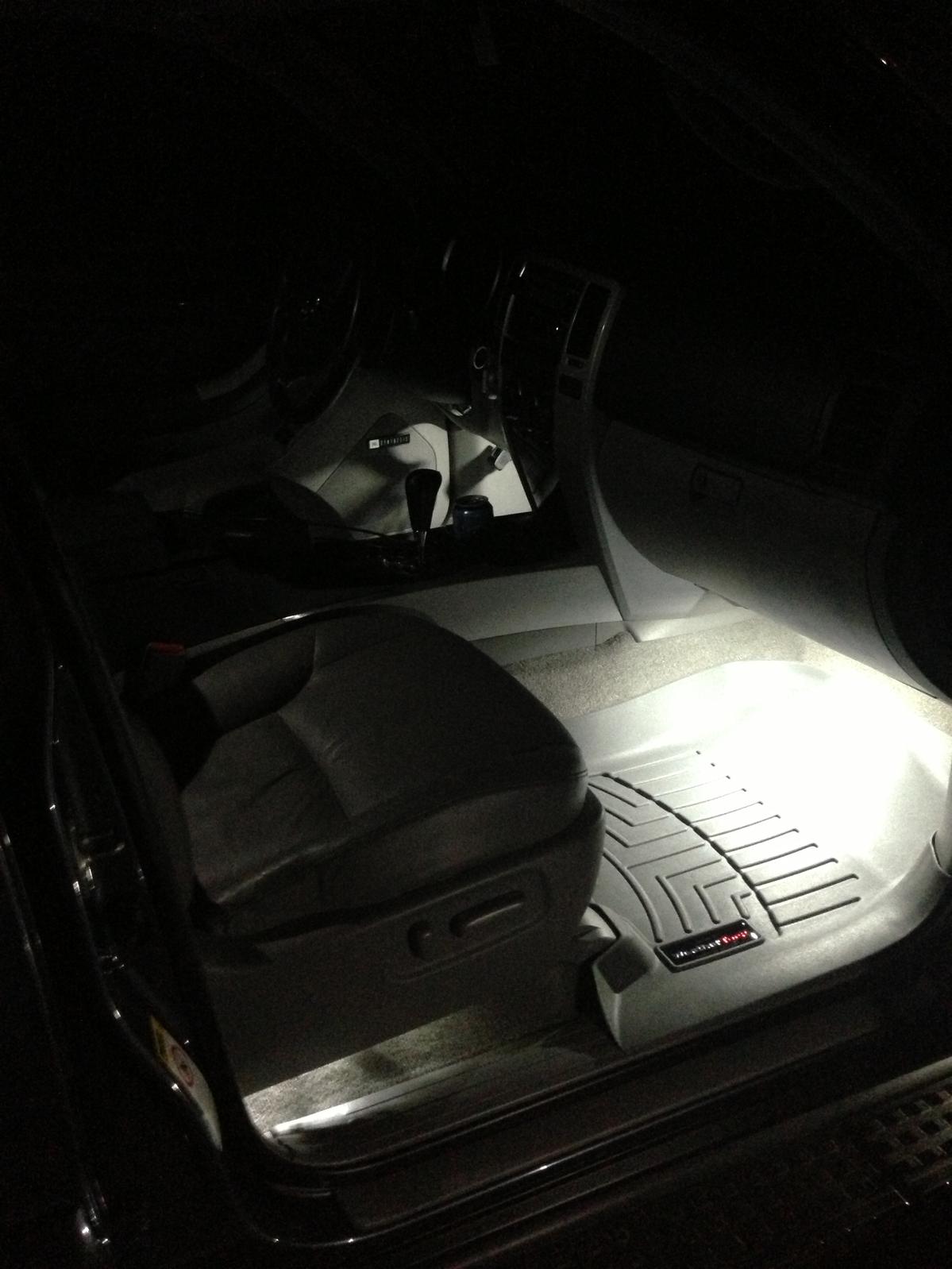

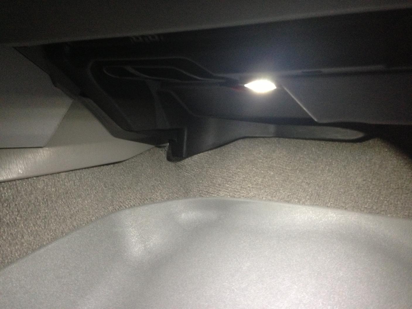

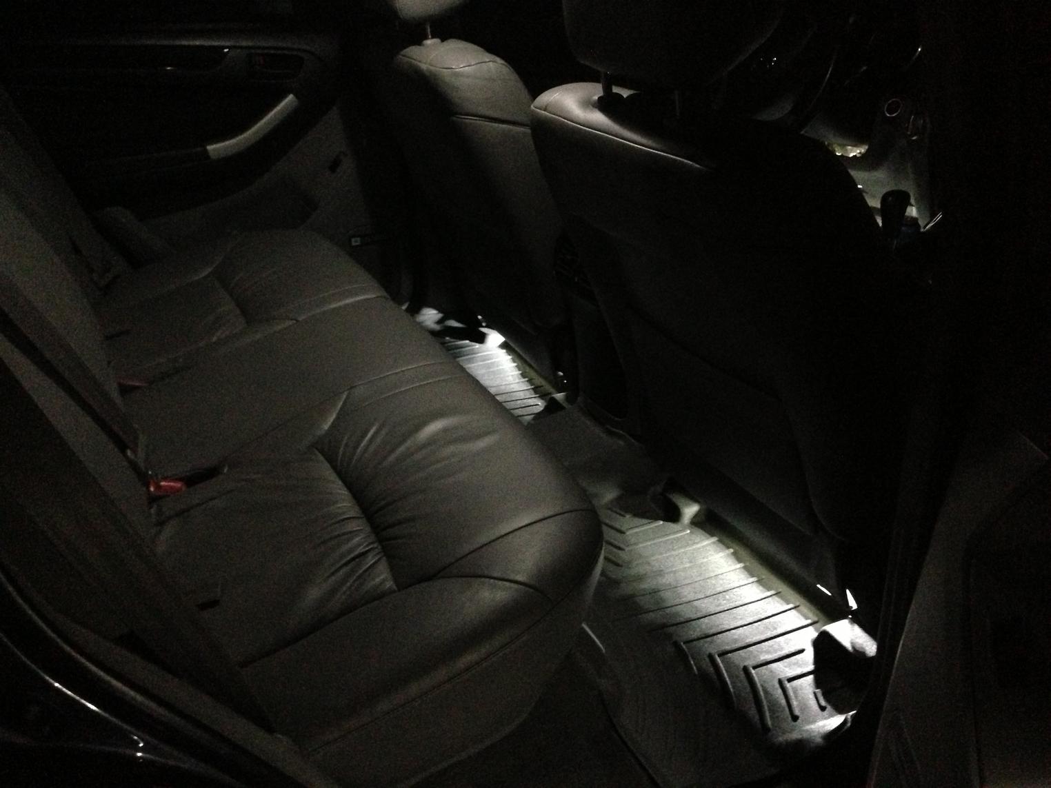

I did the mod and enjoy it a lot! It was a lot of work but imo very worth the time spent. I cant believe they didn't come with any foot well lighting from the factory, when I turn it off it's just too dark for me. I followed JA's write up exactly and had no problems. I used the LEDs from the site he referenced and went with the 5000k (best color imo). I spend about 100 bucks overall and would highly recommend to everyone who isn't afraid to take some panels out. Here are a few pics:
*note that the lights are not as bright as they are in the picture...glare from the mats made for a hard capture
