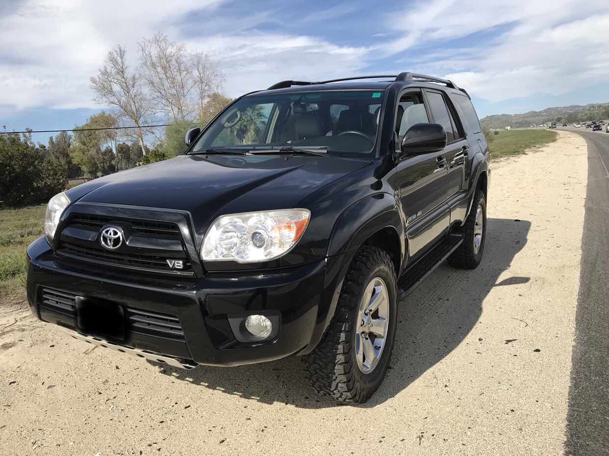

Hi, I’m new to 4runners/SUVs I’m coming from mostly messing around with BMWs.
I was able to pick up my 4runner about 1 month ago from a forum member.
It’s a 2006 Limited 4x4 V8 with about 88k mi currently and looking forward to learning and taking this on some local trails/camping with family.
Here’s what she looked like when I picked her up:

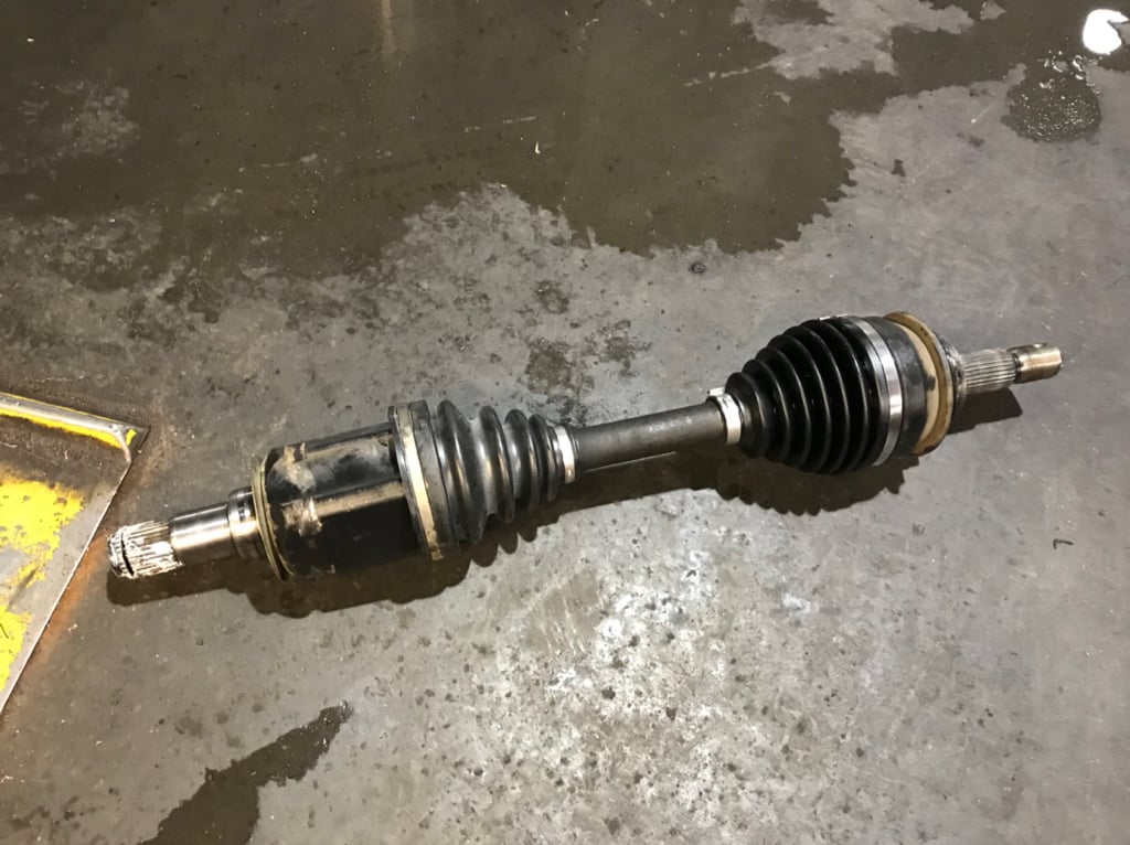

Front CV boots were leaking so had them fixed:

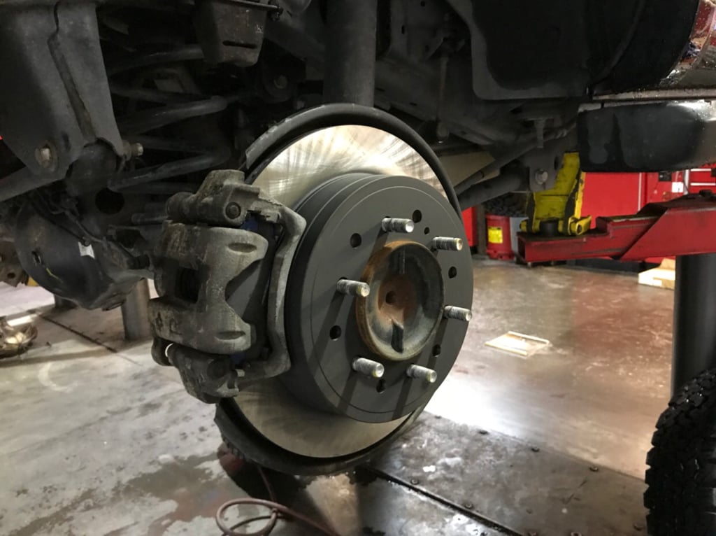

Then needed rear brakes:

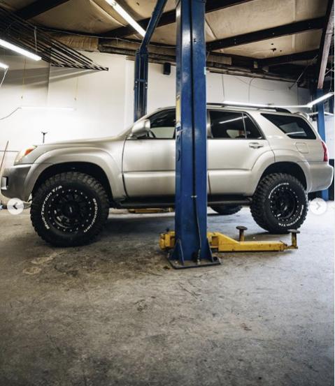

4runner had wheel spacers which I’ve never liked so had to swap out wheels.
I went with 265 70 17 this round

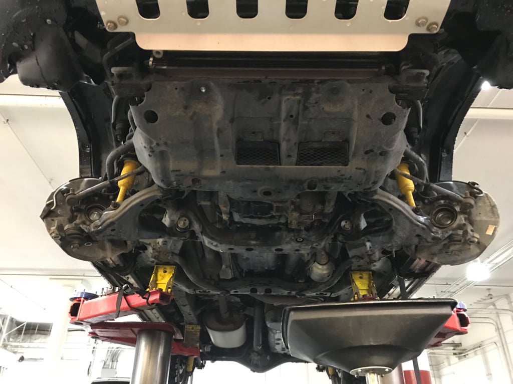

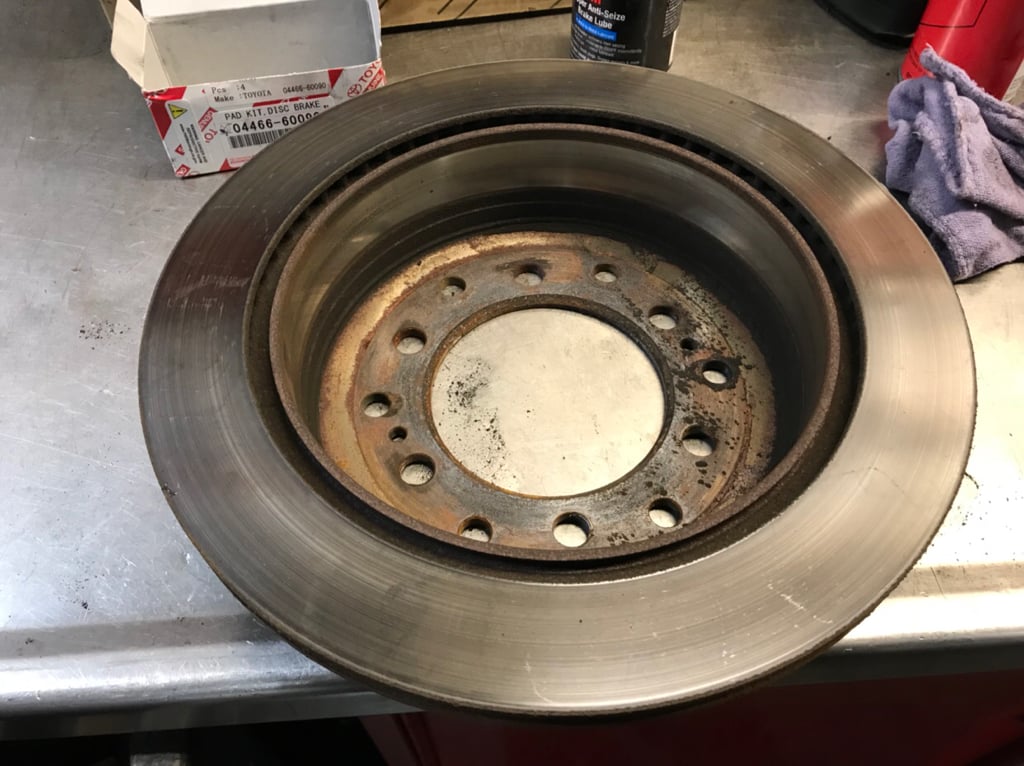

Hey there! Also in Socal. What did you pick it up for! Nice truck. Also where did you get the work done and how much did you get the axles for and how much was install. Been looking for a good shop around SoCal

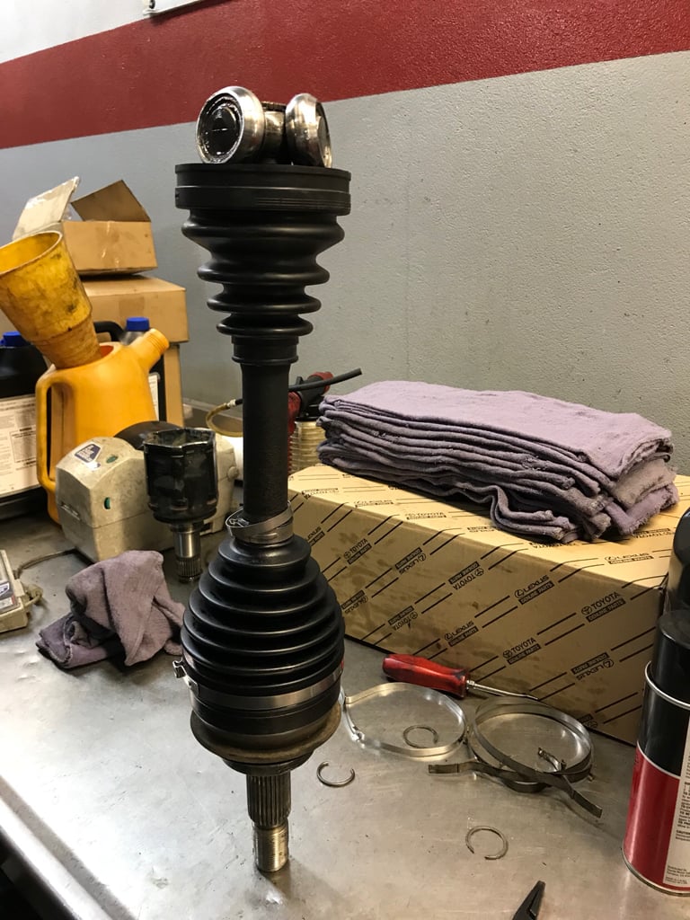

I got the work done at the dealership, I purchased the oem boot kits and had them replaced/repacked with grease. Rather keep my original Toyota axles from going bad than replacing with aftermarket stuff.
Thanks, I’m in San Diego !
the dealership near me quoted me 1100 to replace boots!
smart move, aside from paying dealership prices

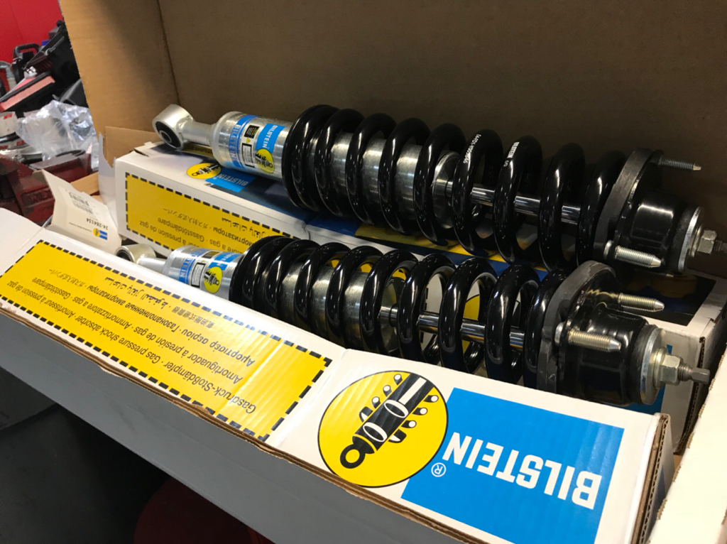

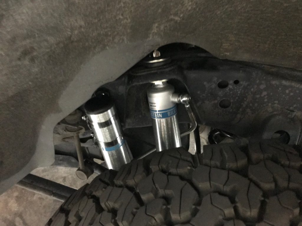

I ordered Bilstein 6112/5160/Icon rear springs.
They literally came in the next day!
The bad things is after doing some searching on this forum I found a new spring options is available 650lbs part# 47-284142. I have a V8 so I really think I should go with this option, but now I have to pay 15% restocking fee and shipping.

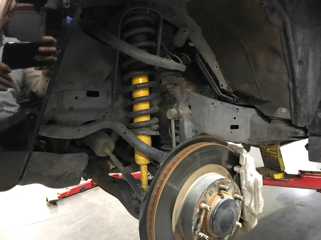

Parts were rerouted to a further store, but I was able to pick them up on my lunch break and have them installed before the weekend.
I got 6112/5160 w/ Icon 2”
Ordered new oem mounts
Old
New splash shield since it was missing
New
I went with the 5/3 setting. This kit is with the 650lbs front springs and it’s slightly higher in the front than the rear. It should settle a bit and I do plan on adding a front bumper/winch in the future so this is perfect.

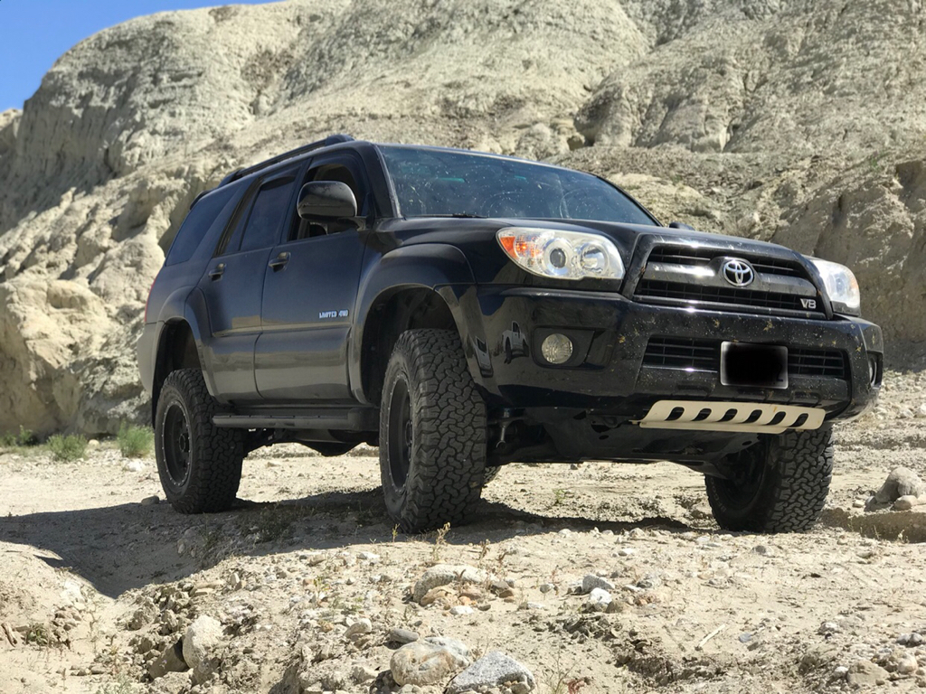

I got to test this setup out in Borrego Springs.
I noticed a big difference when driving over the graded area on the way to the mud caves.
Went out with the kids and a couple of buddies from work.
Next I plan on getting some sliders and upper control arms.
Good looking ride. I think we're running a similar setup. Love the Method Standard's, just put a set on last month. Great offset and good looking wheel.
