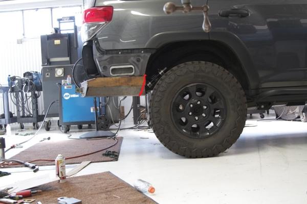

no concerns about the front lower edge of that bumper closest to the tire? I would undercut it to follow the wheel well
like so:
Like this eh? LOLZ
I'm going to use the OEM rear Trail Edition bumper cover to clean up the sides and void under the tail lights. I thought about plating the sides but decided against it for a couple reasons. First off, it would be a ton of work to match the compound contours of the rear quarter panels, and second, there really isnt any where to reinforce the sheet metal too, it would just be some contoured sheet metal panels hanging there. Also, I saw no way to keep sheet metal sides in as close to the body as the OEM covering. Gotta remember, the bumper is directly attached to the frame which moves independently from thy body and you need some clearance between the two.
Function over form. This bumper is built with function in mind first. The trim comes last. Plating up the sides will give me all the protection that I will EVER need and then some.
like so:
Keen eye :naughty: There is excess material there so it can be trimmed correctly once the rear bumper cover is integrated in to the new steel bumper. It will match the lines of the original fender well. That will be one of the last things to be trimmed. Even at full compression there is no contact of the tire on the bumper now, the trimming will be purely for aesthetics.
