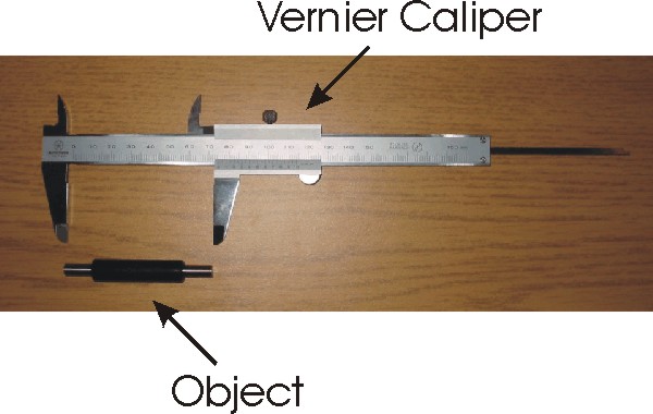

The tool they use in the FSM to measure Internal Dimensions of your brake drums, compared to the External Dimensions of your brake shoes (outside of one to the outside of the other) is a:
You can see the forks going up for ID, and the forks going down for ED.
