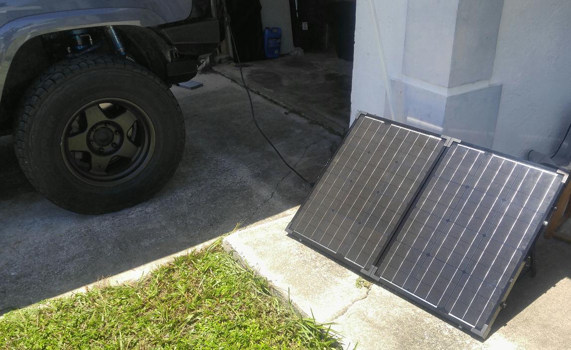

I just got the new 100w Renogy suitcase and will be trying it out next week. I plan on using it to top off my 4Runner if hanging around camp, my Goal Zero Yeti 400, and probably lending some juice to my brother for his trailer battery.

I have dual batt setup and the 100w Renogy solar panel. It's not cheap, but the panel will keep up with my fridge amperage draw and still charge my deep cycle house batt, on a sunny day of course. [MENTION=138432]Liquidmantis[/MENTION] you should be happy with yours.
I think a roll up/fold up flexible panel might be more practical for space and bouncing around on trails, and you can lay it out anywhere the length of your charging cable will allow. This is the only drawback of the Renogy fold up, because you need a relatively flat surface to set it up, and you have to pack it accordingly to protect it from bouncing on the trails, but the smart charge controller is top notch and I'm happy with its performance. A friend who lives in NY state, says they don't like extreme cold, so be careful of that. They will get brittle and crack.

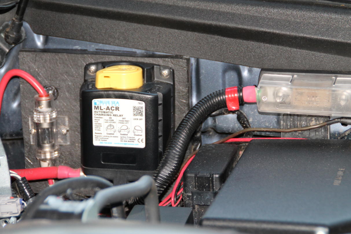

Here is what it looks like under the hood, at least in my V6 4th Gen.
I know it sounds a little ridiculous but these days I just "plug my tent into my truck" before going to bed. Anderson quick disconnects are your friend. I basically have DC power outlets inside and outside in various convenient locations. If I can't do this I would use my ammo can battery pack.
If you want to go down the road of building a setup, I high recommend you check out the Blue Sea ACR and LVD (Low Voltage Disconnect)

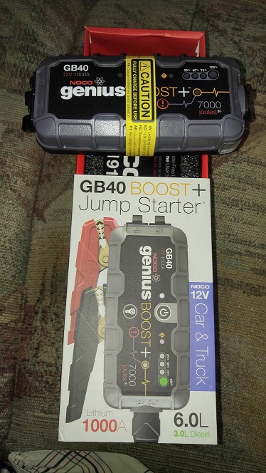

Your idea for Solar Recovery is spot on as I have already made use of it. My high dollar aftermarket high output Alt. took a dump on a trail ride (lesson learned on aftermarket), so I nursed it back to camp with batteries isolated, which killed a cell in the starting battery so it wouldn't hold a charge more than a few hours. With the Solar panel I was able to run my fridge and keep both batteries from discharging completely by switching back and forth for a couple hours.
I needed cell signal for a parts store search, so I drove into town on the starting battery, which gave out. Out of 10 parts stores and 3 dealers in an hours radius, no one had one in stock. So now even both batteries wont start the truck and I'm stuck in town. Get out my little NOCO, start the truck and both batteries have enough to get me back to camp and hook the solar back up.
Luckily I was able to get my Tacoma buddy to bring my stock alternator from the house 3 hrs away. The whole scenario took a day and a half and the Solar panel was a big part of it coming together. I could have walked in to town at any time, so I wasn't stranded in wilderness, but the system as a whole saved me a lot of aggravation.

I really do like that start isolation feature... I did a pretty detailed write up on the smaller blue sea acr if anyone missed that link above.
[MENTION=119302]4RunnerAquasport[/MENTION] I gave up that feature for aux battery priority but your example is exactly why it is there.
I wouldn't mind buying one of those noco genius jump start packs. Its a good product and a huge upgrade from the older style which are much larger in size.
I don't daily drive my 4Runner... so I do use the noco genius 7.2 amp charger/maintainer to keep my packs in good condition and the electronics like the fridge running during pre-trip prep.
