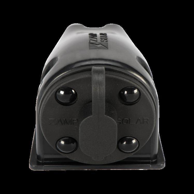

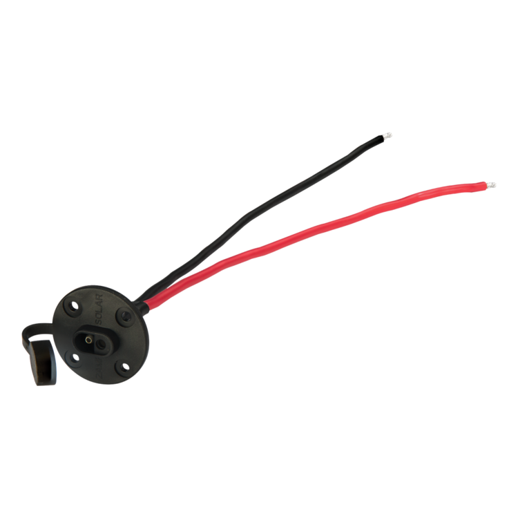

I am wanting to add solar to my setup. I have dual 100aH AGM batteries. The alternator probably doesn't do the best job of keeping things charged, so solar would be a big help.
I don't want to run wires through windows, and I am concerned that the thickness of the solar wires may be too much for my boot over my hatch.
So the thought is, cut the metal, either on the roof or the side, and install a legit solar port. What do you think?
I have two options, I can do roof or side of vehicle:
I mounted up the item in the second picture to my cowl. I drilled a hole in the plastic near the drivers door and screwed it in there. Then ran the wires under the plastic shield on the fender to the battery.
It also worked for my trickle charger/battery maintainer.

I think you mean you ran it to your solar controller.......hooking a solar panel directly to a battery is not a good idea. Trickle charger would be fine, it is "smart", but panels are generally unregulated. Do you have pics?
My solar controller was wired to the back of the solar panels. (brief case style) So yes, I did mean I ran it to the battery.

If you are considering that location, the panel just pops right up. You will have to trim a fin or two underneath. Just make sure you get it centered in a good spot. There isn't a lot of room to work with on that panel.
I am still not sure I understand what part you are talking about. Are you talking about the black plastic trim between drivers and passenger doors?

I have my on-board charger 120v port on the plastic cowl in front of the window, i made a little cover so it doesn't fill with water in the rain when it's plugged in (although it has before and didn't seem to impact anything)
it will get water in it if you put it there, so you'll be limited when you use the panel or will need to make some kind of cover or get a weathertight connection. i installed mine knowing it wasn't the perfect location, but it's a really cheap part to replace if i ever change my mind and i couldn't find any vertical surfaces that were similarly cheap to replace that didn't require opening a hood or door and weren't somewhere that was going to get really muddy
