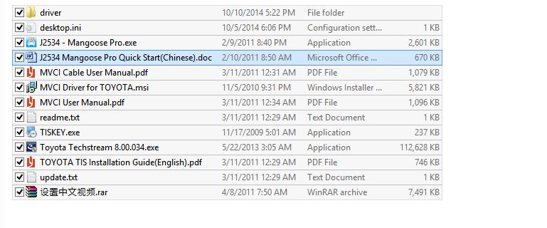

The content of bundled mini-CD:
attachment.php
The Techstream, MVCI drivers and TIS Key all can be found on the Internet as well.

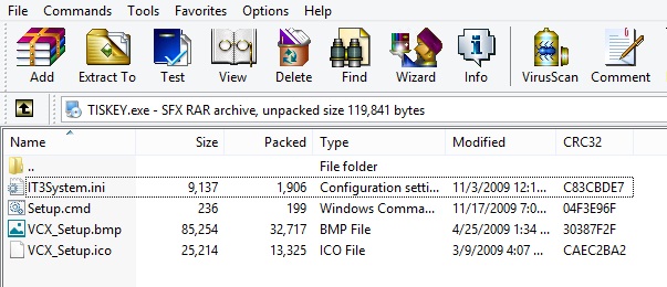

  • Now open WinRAR again, navigate to the temp folder with unpacked files and double click the TISKey.exe in WinRAR.
    attachment.php
    The TISKey.exe is actually a self-extracting (SFX) RAR archive file. Once executed, it simply unpacks and copies the IT3System.ini file to the Techstream folder. Extract that IT3System.ini to the same folder for now.

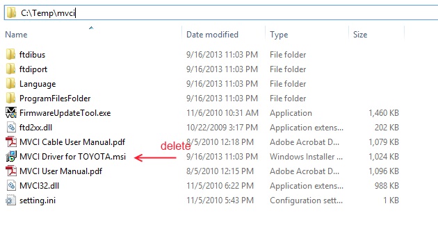

      This will extract the content of the MSI file to the c:\temp\mvci folder:
      attachment.php
    • Delete the “MVCI Driver for TOYOTA.msi” there and then copy the whole
      content of c:\temp\mvci to "C:\Program Files (x86)\XHorse Electronics\MVCI Driver for TOYOTA TIS"

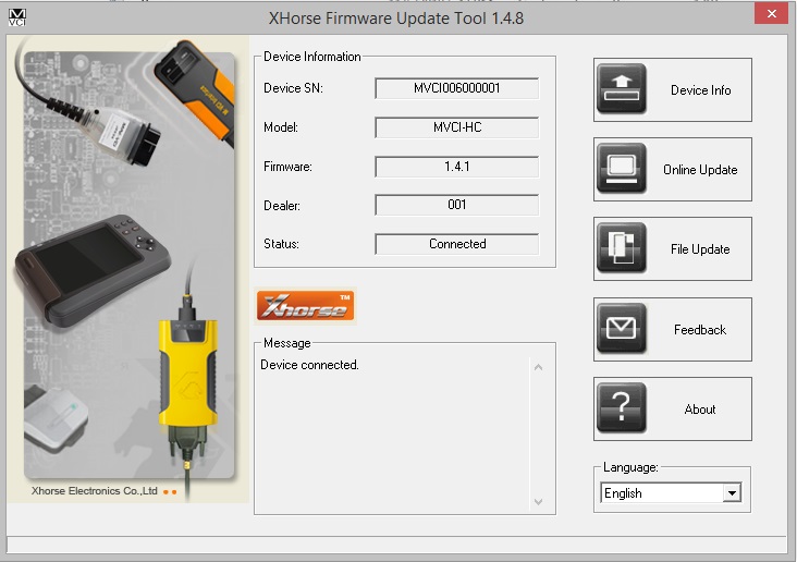

    • Run the FirmwareUpdateTool.exe from the "C:\Program Files (x86)\XHorse Electronics\MVCI Driver for TOYOTA TIS". Click “Device Info”. You should see the “device connected” screen like this:
      attachment.php
      If you see this, it means your MINI VCI is up and running under Windows x64 and can be used by other programs, such as Techstream.

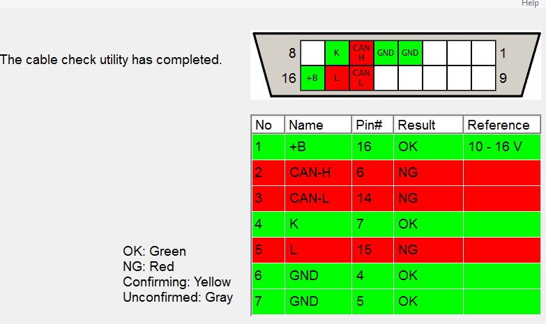

The built-in Techstream cable diagnostics shows:
attachment.php
So far, I tested the cable with 2013 4Runner, 2004 Sienna and 1997 Camry LE/4cyl, and it seems to work fine with all of them. Absence of (L) line connection means no support for ECU re-flashing (which is not something I'm comfortable doing myself anyway). Option customization/clearing DTC is possible (already verified).

Thanks for all info. It worked very well, but then I did the upgrade to 147 firmware and now is dead. I can find it with firmware tool, it looks ok, but in the car it gives me nothing. So don`t try to update firmware for mini-vci.
PS: I had all lines green (K), only L red, so a lot of information from the engine.
