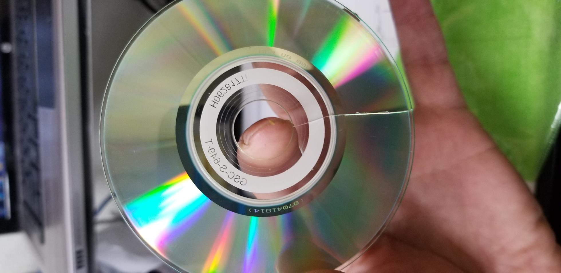

Just got time to install but look my disc that came in the mail is broken �� tried it any way but no luck keeps spitting it out
can some one copy the cd for me please
