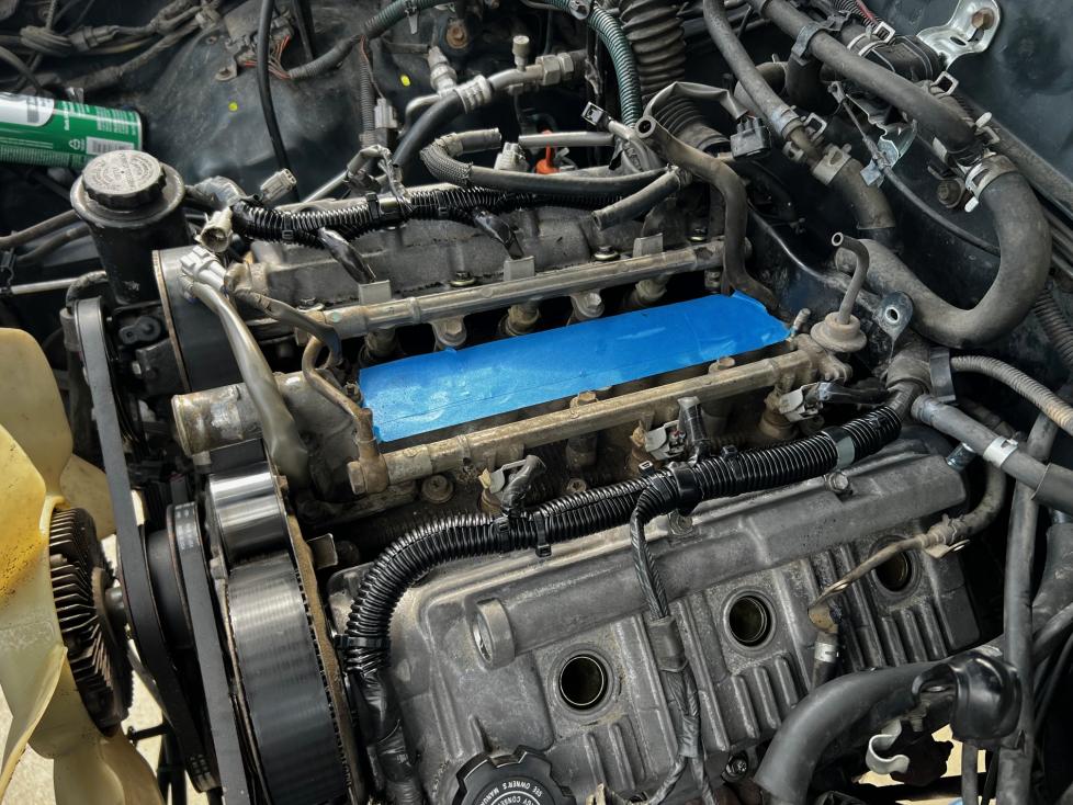

Just did my VC gaskets the last few days and used the black vulcanized rubber tape, followed by loom and cable ties, and then the napa metal clamps to bolt back into the factory bolt holes on the valve covers. That tape is really nice stuff and looks like the factory stuff they used.
