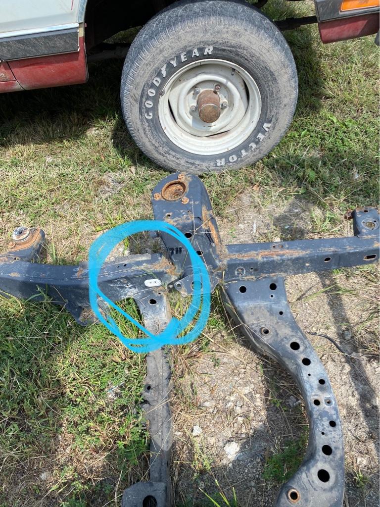

I’ve been trying to find this part but so far no luck.

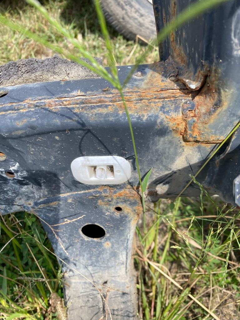

On a 2000 (maybe all 3rd gens?), the evap breather line vents into the frame rail via a plastic fitting just above a crossmember.
Photo is from my old frame. You can see that the plastic fitting is broken. My new frame didn’t have one attached, so currently my evap breather hose is just kinda dangling and venting down near the steering gear.
(Not sure if it makes a difference, but while my truck is a 2000, my new frame is a 1999. I bring this up because there have been a few minor differences between the two years: position #2 body mounts, spare tire stability bars, etc.)
Part number? Any clues? Thanks!!
Just updating this thread to say that Toyota Part Number 7777535010 "GUIDE, CHARCOAL CANISTER OUTLET" is discontinued and no longer available.
I found one on Toyota Parts Overstock and ordered it, but a few days later they emailed and said they cancelled the order and refunded my card because they didn't have the part and couldn't find it anywhere.
Anyway, it doesn't really matter since it's just for holding the evap vent tube in place at the hole in the frame, something a zip tie can do just fine.
In the off chance anybody has one laying around or finds one online, I'd be interested in it. But it's no big deal.
EDIT: Amayama looks like they have the part in stock. But so did Toyota Parts Overstock, so we'll see.
Update: Amayama cancelled my order saying "Production stopped." So, I guess that part is gone for good. Oh well, not a big deal.
