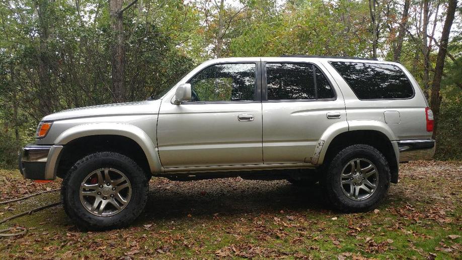

I have been collecting parts for about a year. I ended up with 2017 4runner front springs from an off road/trail model and 2013 rear springs from an FJ with 3rd Gen 4runner Brillstein's on all corners. The Fronts are set on the bottom for zero lift. The tires are 265/70-17 Cooper SRX because I spend most of my time on paved roads. I ended up with 1.75" +/- in the front and right at 2" +/- in the rear. I had 4 used Michelin 265/70-17 and 3 80lb bags of concrete in the back and the rear dropped 1/2-3/4 of an inch when loaded.
