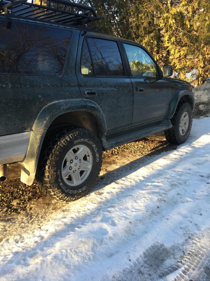

This is how my truck looks with 881s in front and 906s in the back - at least 1” higher in the rear. Think I really need those 10 mm trim packers for a level stance with those Delco FJ coils?
Hmm. I lifted my front a little more than you I think. My stock height in the rear was also a half inch shorter than most in the rear to begin with so 2 inches to me might be 1.5 inches to you. You probably could get away without the packers if your front isn't lifted too much. I sit higher by .25 inches in the rear with no weight and I lifted the front 1.8 inches. You can always buy packers later if you want!:) I have some pictures of my rig before and after in an album in my profile info if you want to see the lift difference. I'm not sure how to post pics here tho.
All this is so variable. The 881/906 combo was supposed to give a relatively level 2” lift. I’ll have to get some measurement on level pavement, but seems like I have closer to 2.5-3.0” in the back - and that is with 160 lbs. of wood pellet bags behind the rear seat! Otherwise, everything else is stock. I bought the trim packers so they are on their way - just a question of whether or not I have my mechanic put them in.
I would put the packers in. It definitely won't be a 2.5 or 3 inch lift.

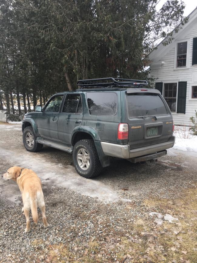

Looks even higher than before after the FJ coils and trim packers! Ride doesn’t seem that different either. Not sure where to go next.
If you haven't replaced shocks in the rear I would do that before changing coils again. Putting in new coils with old shocks won't make your ride much better. Remember that new springs will settle some after a few thousand miles. As for the ride. I an not sure why it feels stiff for you. I don't carry any weight in back and can have an almost empty gas tank and it still rides awesome! Maybe it is just such an improvement from my worn out stock setup but I absolutely love the ride.
