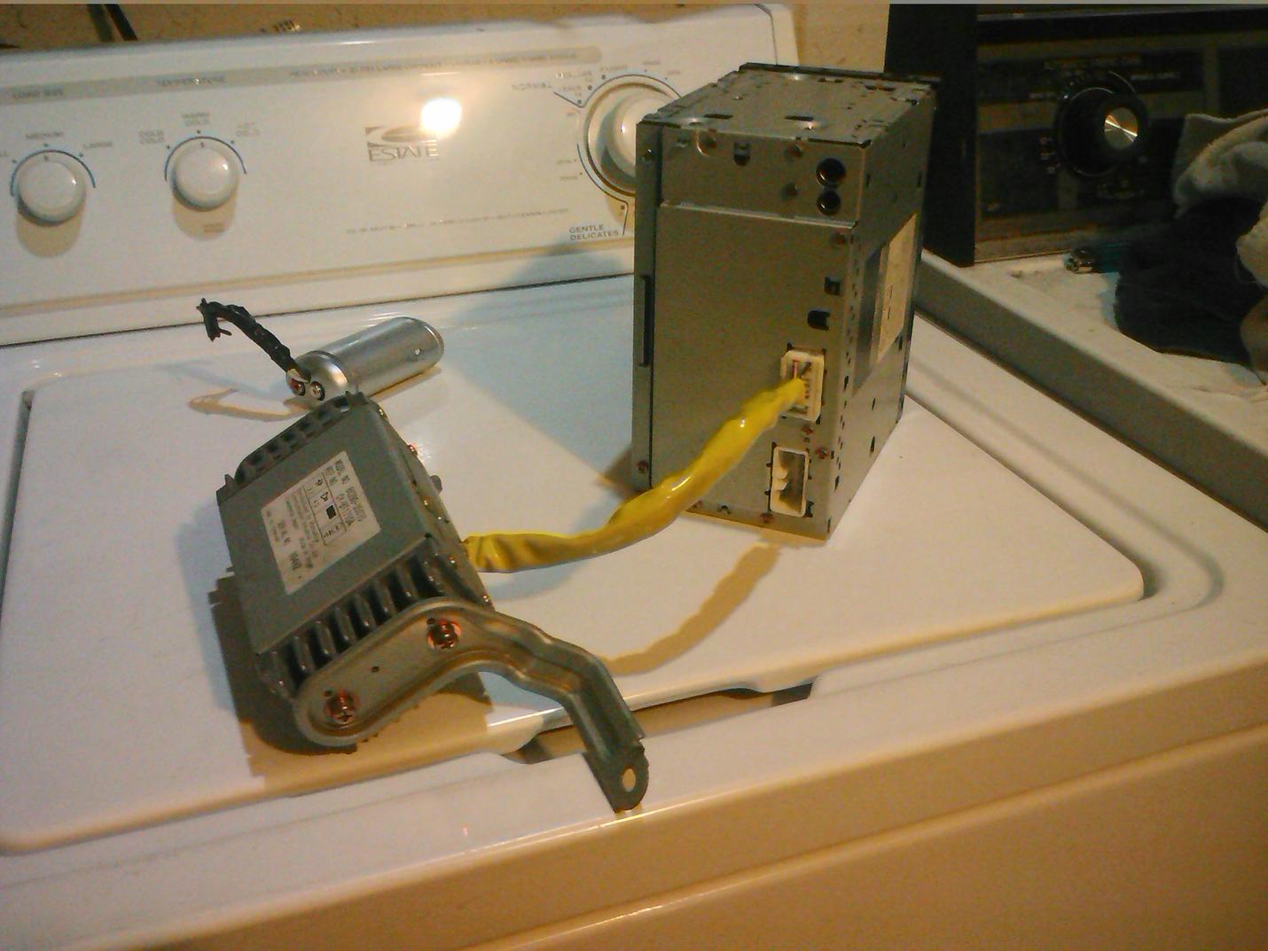

The sales guy was probably thinking of BS you have to do on a lot of newer cars to bypass the amp you literally have to run new speaker wires. That's not the case with our rigs just get the harness adapter should be the same from 85-03 and pull the factory headunit out pull the factory amp out should all look like something pictured below. Then just plug the harness adapter in take the metal brackets off factory stereo and put them on the new one then your done pretty much.
As for factory speakers being jbl I doubt it mine have no markings I upgraded my whole system the last couple days with hertz door speakers jl 1000.1 slash amp and Phoenix gold comp 10.

For anyone who reads this later.... Don't use the stock amplifier with an aftermarket head unit. It sounds like shit. Go ahead, ask me how I know.
