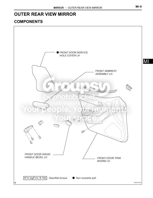

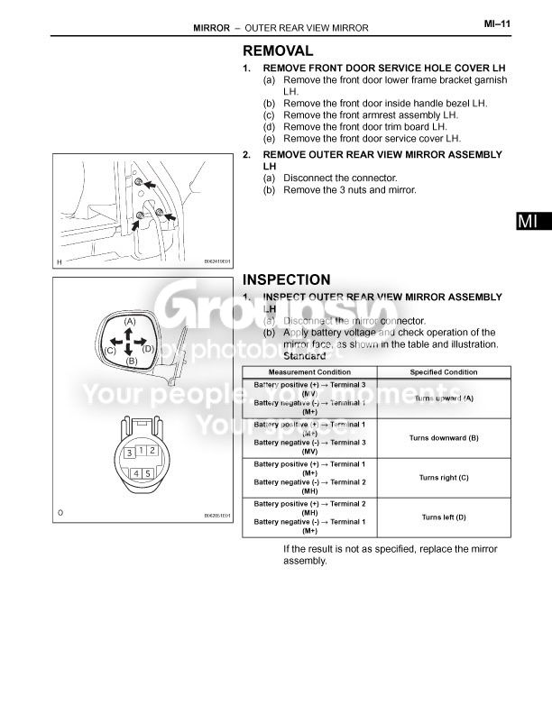

060001mirror1copy.jpg~original
If you can, get a friend to hold the door panel up so it doesn't hang by the cables and wires inside,. It's very easy to break the plastic ends on the door opener and lock cables.
