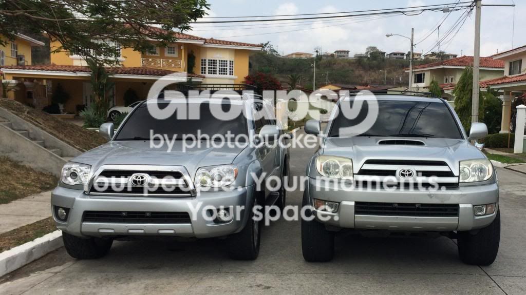

well my name is Javier Jordan, i'm from Panama city, Panama. I have a toyota 4runner 4th gen 2005, but with a little different from yours, mine is 3.0 diesel turbo charged intercooler 1kz-te. She has 127000km with any issue until now.
Also she have 20" konig with maxxis victra 275/55 and a little sound system.
it was my moms car and she gave it to me. It is a little expensive to bring suspension parts to panama so daystar or revtek are not an option and i dont do off roading all the time so i was considering this options In Panama that there are two dealers OME and ironman, wich Ironman suspensions are cheaper and almoust with the same quality as OME. So if you can tell me which one to use?
I will change those wheels but i dont know what rims size run. i am not sure about if 17" or 16", so if you can tell me what would be better it could be perfect.
My other question is: what i really need to run 33s tires on 16" or the same on 17". I really need to know because we dont have the same aftermarket that you have there in the US, and I need to buy the parts. Sorry for this question because i know there is a lot of info on the forum but i dont find exactly what i need.
Thanks for all the help that you could give me. Sincerly Javier.

Welcome, It almost looks like you have a lift in the rear already.
Not sure about the ironman, but, someone will eventually post up. Everything on yours should be able to modify like our gas models except the motor section.
EDIT- You should be able to do the 33"on 17" or your 20". Just need to do the lift and some other items to fit without the rub issues. Search is your friend and if not sure after that feel free to ask what you don't understand.

No, I dont have any lift, I wish to have one jajajaja. The suspension parts are the same, also I think the transmission is the same.
Probably just the angle your ride is sitting on the ground. Just do some searches, there are easy ways to do these things from others posting.

you can run 33s on the 20 inch wheels you have now, but you will need to space it out or else itll rub, i have 32s on my 22s and they rub sometime on full lock to lock turning. im sure a mild lift and some wheel spacer might help. im on stock suspension sport edition.
After some time I had done some mods to the 4runner. Spacer lift kit in front 3" and in the rear fj coils with 1.25 spacers. Front grill and hood scoop with plasti dip.
Before and after
with another runner
New color on the grill and hood scoop
