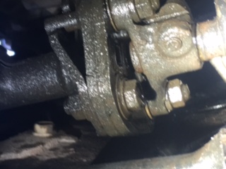

The first photo (sideways) seems like the source of this leak. This is a hose/tube in my engine bay. I can't tell what this thing is hooked up to, but it kind of looks like it goes down to the power steering rack? What the heck is it supposed to be plugged into in the engine compartment and why does it seem like the little cap that's on the tube isn't actually sealing it.

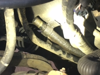

The second photo shows the drip points. The steering rack boot has been torn for a while, so I knew that.

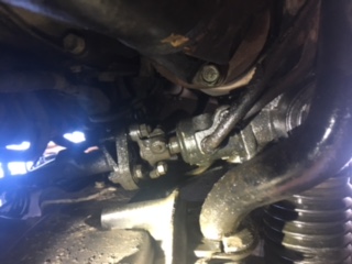

Third photo is a bit of a zoomed out (sideways for some reason) of the area.

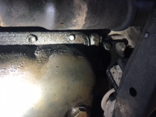

Fourth photo shows a crack that seems to be coming from where my steering wheel connects?

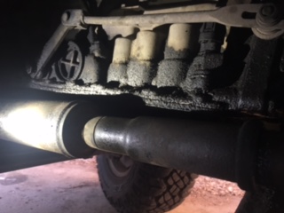

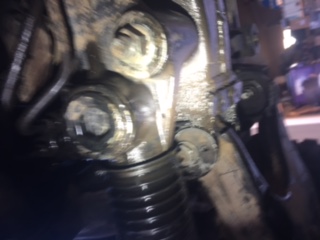

Fifth photo shows a lot of grease getting thrown on to my transmission from my drive shaft. Sixth photo follows that down a bit.

Not so big. Don't sweat it. That hose is the breather for your front diff.
I'm betting you changed front diff fluid at some point and filled it right up to the lip of the fill plug. Then at some point you went for a long drive in 4WD and warmed up the front diff. Then the fluid backs up the breather hose and makes a mess.
Mine did this 2 winters ago after driving for several hours in 4wd at moderate speeds. I believe the service manual says the front diff fluid levels can be a little below the fill plug. It has been covered here before if you search.
I just cleaned mine up and it has never happened since.

The first photo is the breather for the front diff. If you drive in 4wd a fair amount, the gear oil heats up, and they can puke out a little gear oil. It wouldn't be a bad idea to check the oil level in the front diff, so it doesn't get too low.
It's hard to say if that's the source of all the oil in your pics, without inspecting it in person.

That is exactly what it is! It smelled like gear oil (which is really distinct), but I checked all the places gear oil goes and I didn't see any leaks.
Yes, I topped off the front diff about two weeks ago after forgetting to top it off after a CV axle change back in August. Back then I had put the remnants of a quart I had left over into the diff after the CV axle change, but I forgot to go back and top it off for a while.
I have been driving in 4WD more the past week with the snow we've had in town and the 4 hour round-trips to the ski hills here. In fact, I noticed the very distinct gear oil smell when I stepped out of my truck after arriving at the ski hill last Thursday and I looked under my truck and saw what I thought was my CV boot had torn and sprayed grease everywhere, but it seemed more liquid than moly grease. Yes, there was a good amount of 4WD engaged during that drive.
I guess that's a good feature instead of exploding my diff because it's too full of hot fluid?
I guess I'm going to go to the pressure wash place and spray all of that out at some point. Is there anything special I have to do to close that blow-off valve back up?

Since you said you topped it off, it was likely just a bit overfilled. Hence the puking out the excess when the oil heated up and expanded from all the 4wd driving. I'd say the level is probably where it needs to be now, but you can check if you're concerned.
As for the breather, there's nothing to fix.
I wouldn't get carried away with a pressure washer though. High pressure from those can force water past oil seals, or into electrical connectors. Both are bad, but the problems they create usually won't show up right away.
If you want I'd probably clean up the gear oil with some brake cleaner on a rag. You don't want to spray brake cleaner at oil seals, either.

Thanks all! I pulled it off yesterday and it was clear. Cleaned everything up and pulled the cap off of the breather too to clean out the dirt that accumulated. I'm still a bit concerned about that crack on that part of my steering shaft, but I think I've seen that before years ago and it hasn't gotten any worse.
I also taped up the steering rack boot that was torn. Hopefully that holds for a while longer until I can get a new/used daily driver and venture into replacing that rack myself in the next year. I got it replaced as soon as I got the truck but it wasn't a great shop and I'm sure they just used a reman'd one or something.
