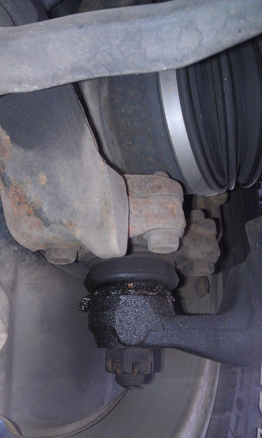

Well I think the mystery is over. I dont think I will drive till I get this LBJ replaced.
So I replaced both the ball joints (which was suprisingly easy) and while I was there found that the right side sway bar end link was broken. I replaced both of those as well. I also did the sway bar bushings.
The issue seems to have gone away, but my handing is so much better now.
