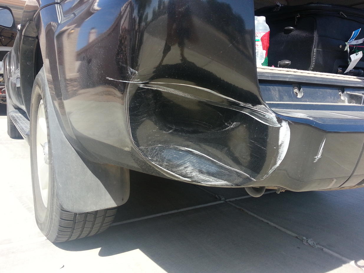

some son of a :censored: did this to my T4R :cry2: in a parking lot and didn't leave a note :gun6: . I don't think I will make a claim with ins, but use it to try to convince my wife to put a steel bumper on. (that will never work).
So...how do I go about fixing this? Can I just take the bumper off and push it back out? Heat it up with a heat gun from the inside and then push it? It is some pretty hard plastic. Let me know what you think.

thats a pretty big dent, but ive done something similar on my rear bumper (not as big of a dent) a couple times already and each time I've pushed it out with my fist and a heat gun.
although after the last one, it does seem like it's a little not aligned with the rest of the car, but the actual bumper cover can in fact be pushed out with a heat gun and some force.

My dad just had the exact same thing happen. Hit it with a heat gun and pushed it out from behind. After some buffing and polishing it looks good as new. Good luck, sucks someone would just run off like that though
Yeah I would go with either remove it and heat gun/massage it from the back. Or lift it heat gun and a pry bar. Be careful if you use the pointed side too hard it will poke a hole and more frustration(did it on a Prius at work a few years back) . Buff out the scratches and rhino-line it for protection or plasti dip it.

Heat gun would be better but i suppose hair dryer will work! as long as there are no creases i think you will be ok. Other than the paint job and being a little out of shape.
I got a big dent exactly like that by "dropping" the rear on rock. I took the bumper out and gave it a kick from the behind. The dent just popped out like it was never there.
