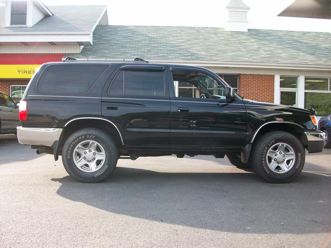

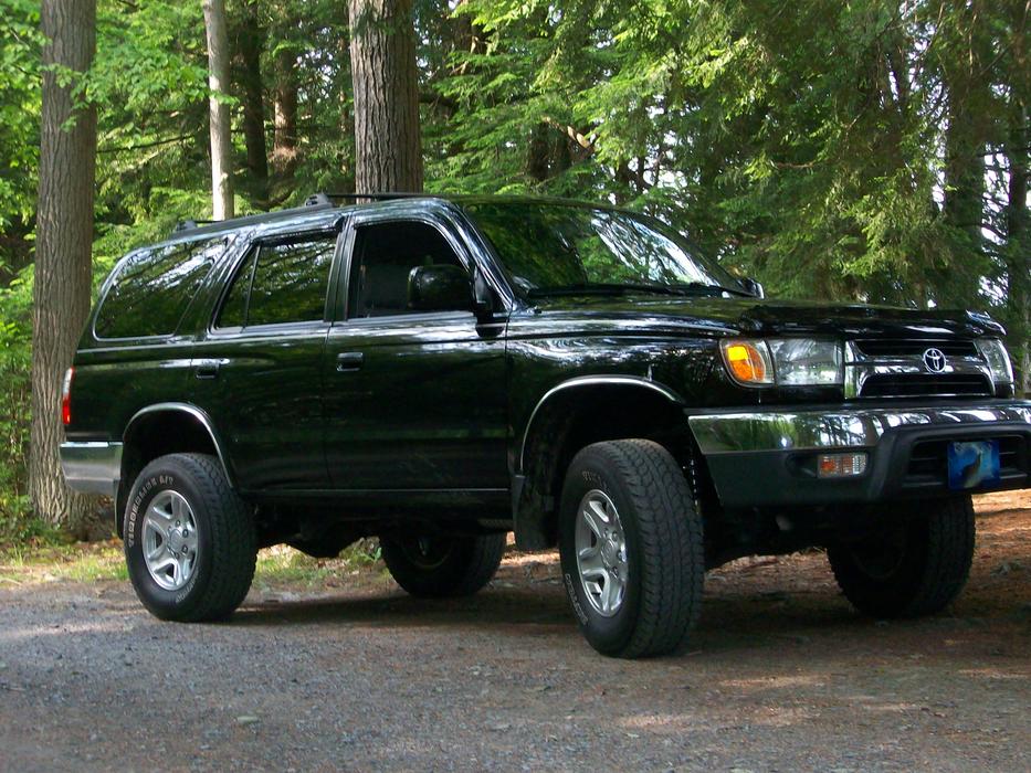

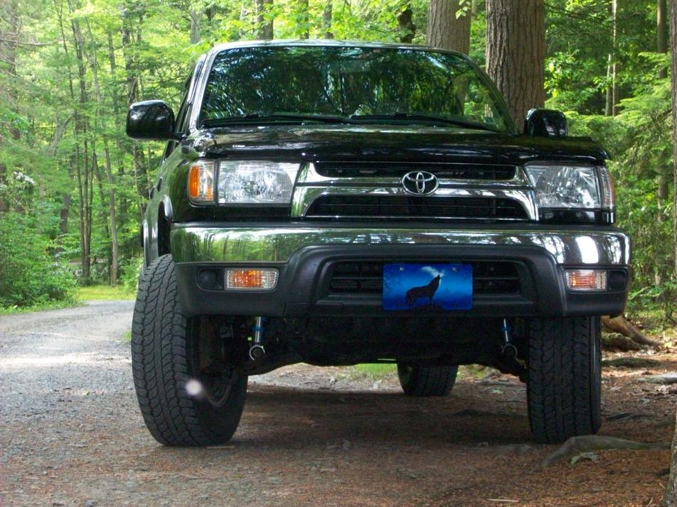

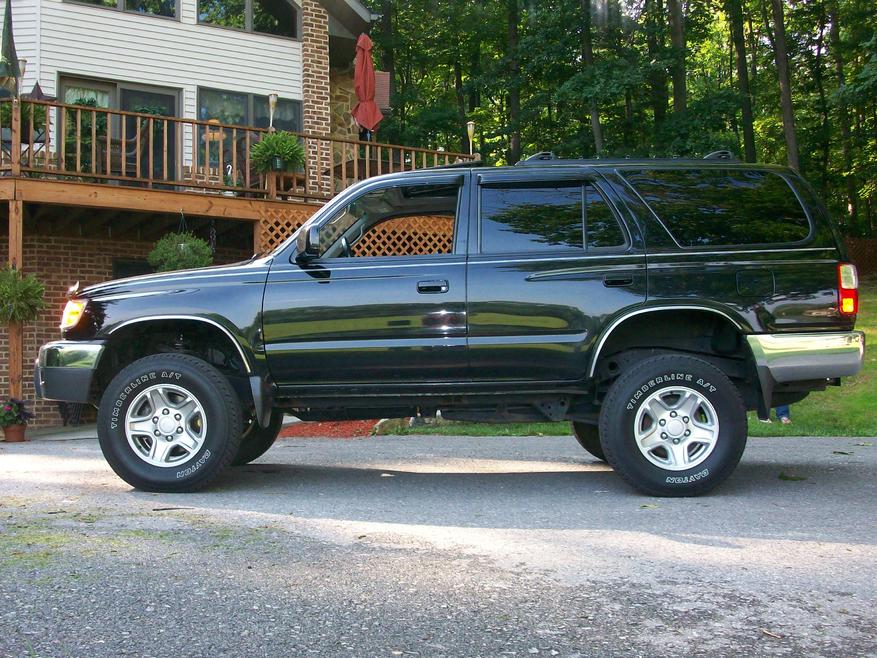

Pics as promised. Sorry I haven't had time to post them sooner!
Before(lowrider stance):

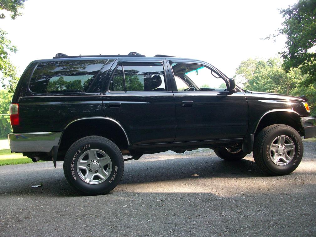

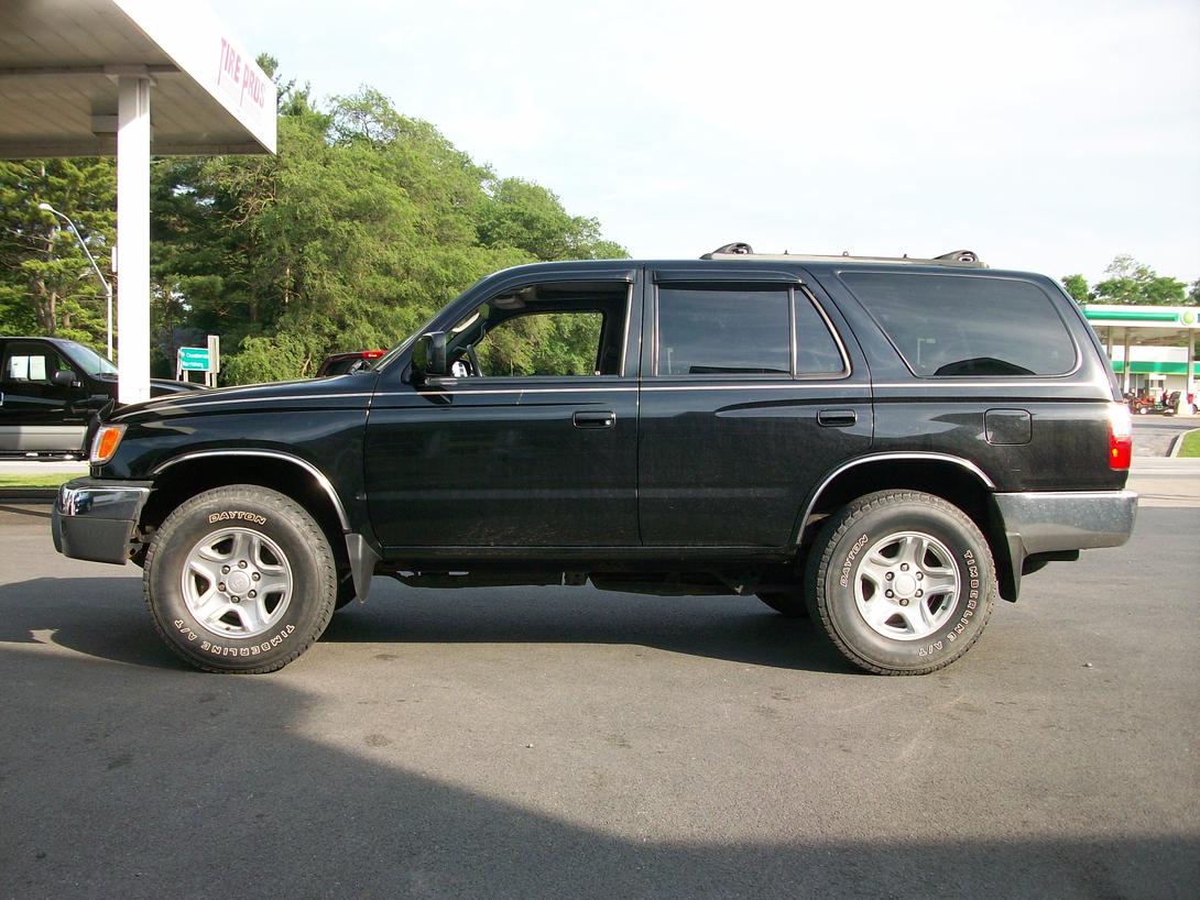

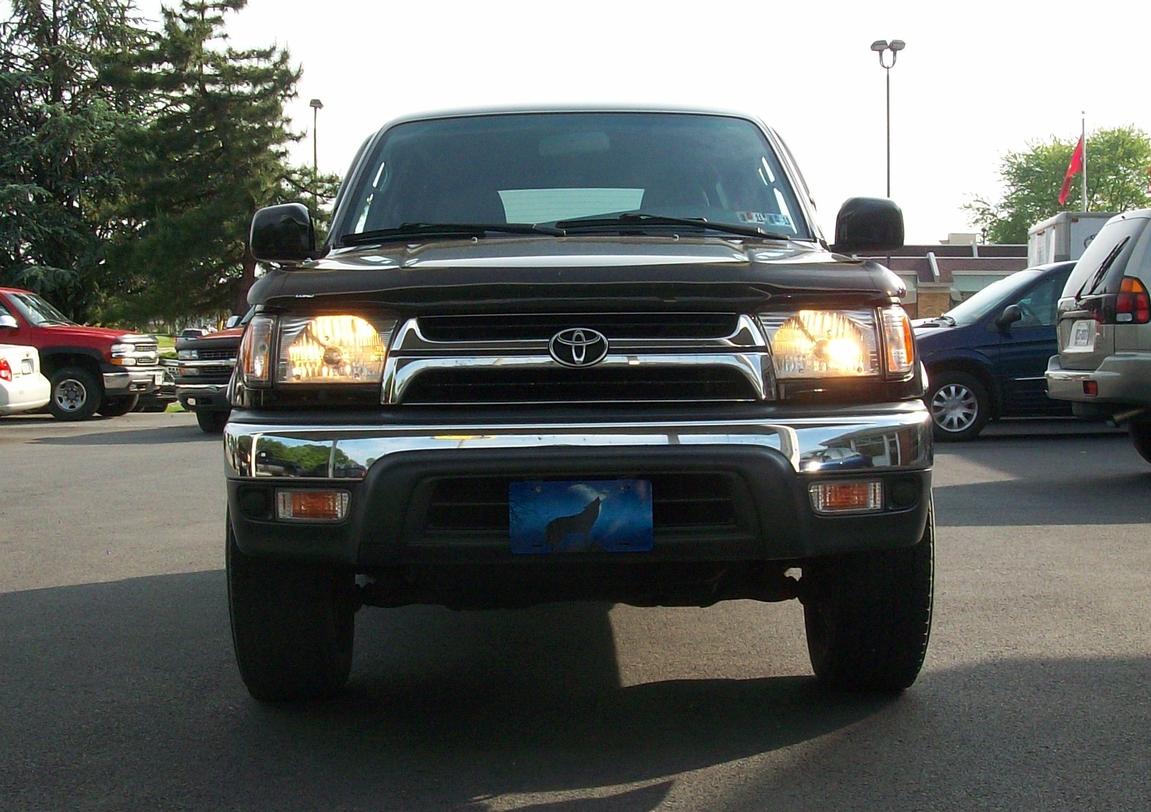

After Sonoran Steel 1.2 lift(before new tires):
Looks good, i noticed that your putting 265's on it, whys that?
Thanks! I really like the lift so far! I decided on trading my 285s for 265s for several reasons. They would rub on the a-arms slightly at full lock with stock rims but that could be fixed with spacers. The problem is in PA it's illegal to run spacers over 1/4". I could've bought new wheels with a different backspacing but that would put my tire out past my fender trim. In order for it to pass inspection, I would need the tread to be covered with fender flares. I don't have the extra cash right now for wheels and flares, so I decided to run the 265s for now. Eventually when I have extra cash I plan on upgrading.:bluejump:
