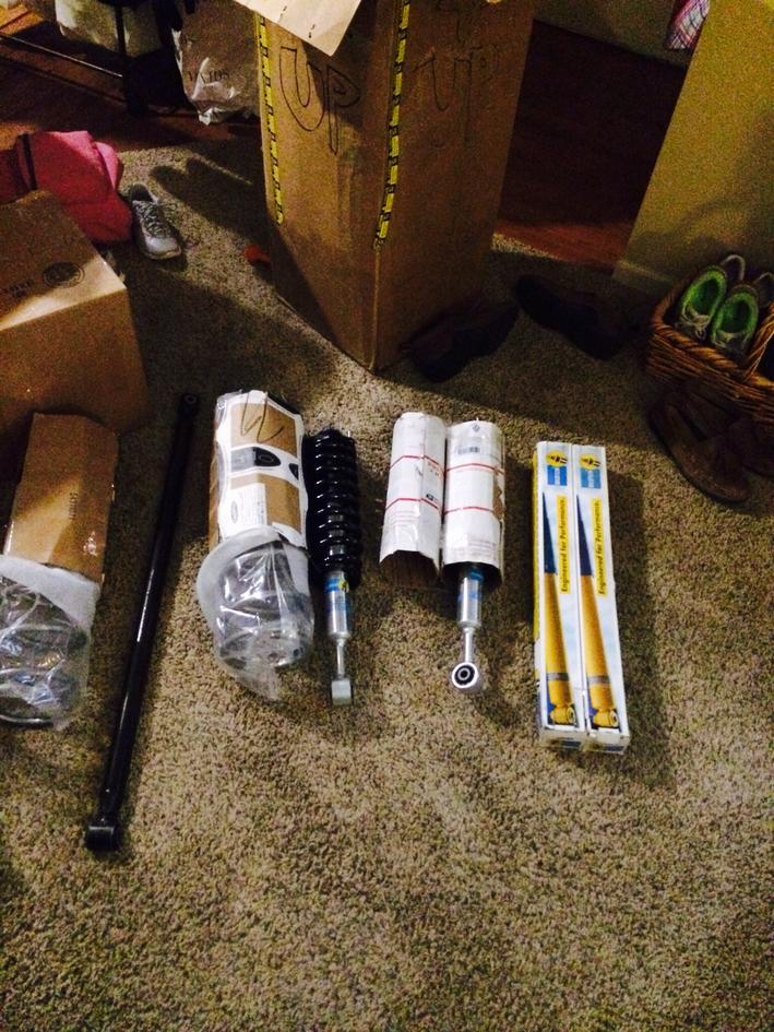

Kit finally came today. Im really excited to get it installed. We're building a house here in kc so we're in an apartment for the next few months. The UPS guy carried it up 3 stories to get it to me. I felt bad for him and now it'll be fun carrying it back down lol.
Congrats! Sad though. If I was any where near you id offer up my garage. The ride is a lot better!
Yeah no kidding I wish you were nearby too! My friend runs a shop and fortunately is going to be able to help me on a Saturday in the next couple weeks. I'll post pics when i have the lift on and also as soon as I get tires/wheels.
