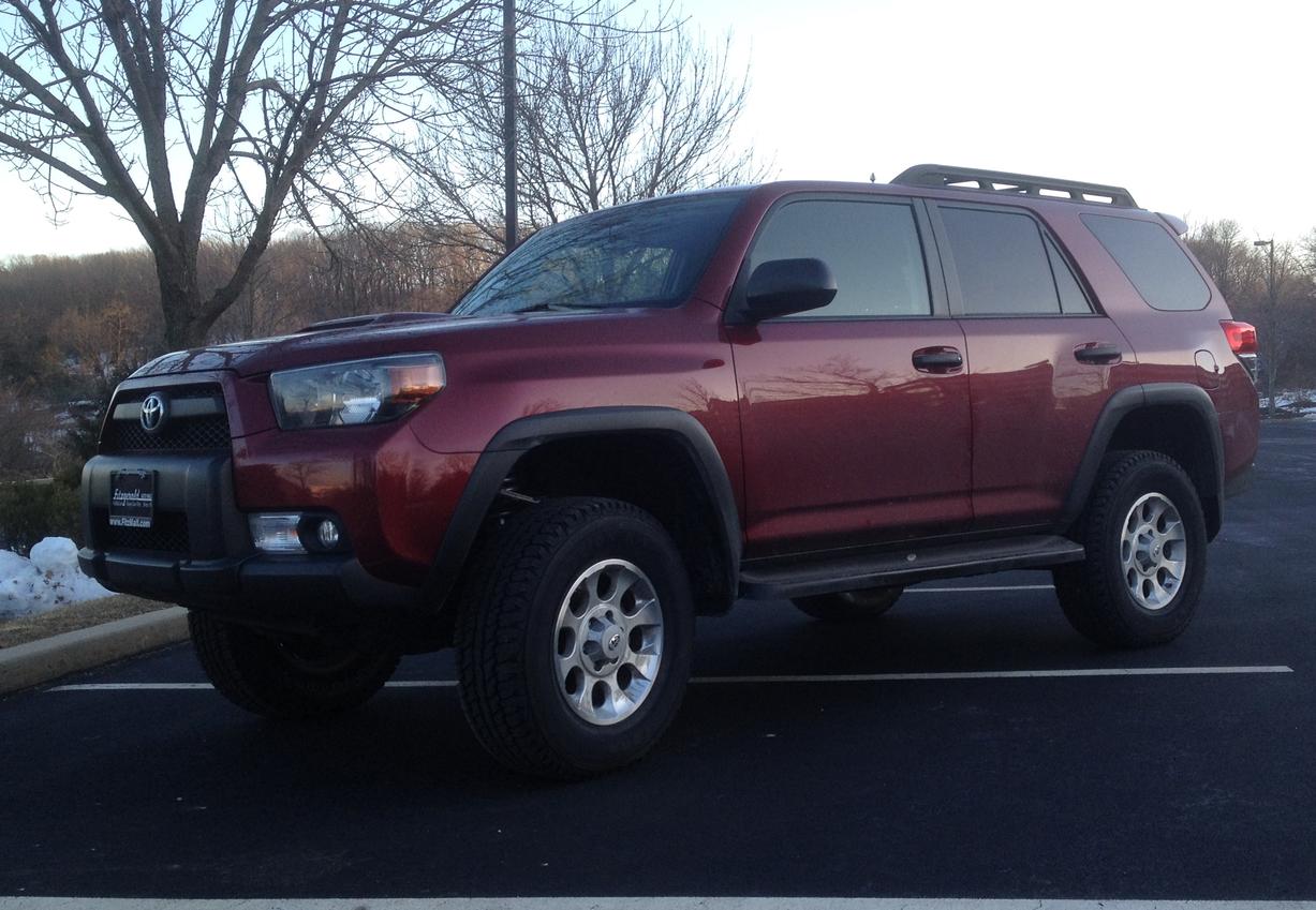

Another satisfied customer posting to vouch for Steve's incredible service & great product.
I went a little different route and installed the TRD springs on the 2nd perch (0.85") of the 5100's, which yielded me exactly 2" upfront and I am exactly level driver to passenger. I also went with the Camburg BJ arms through Steve and I got 3.2+ caster both sides and 285's clear with no rubbing (I did Harper7's fender liner mod before tire install). The SAW springs are from another member who ran them with a rear bumper for a bit, so I ended up with only 1.5" rear lift. Thanks again Steve!
