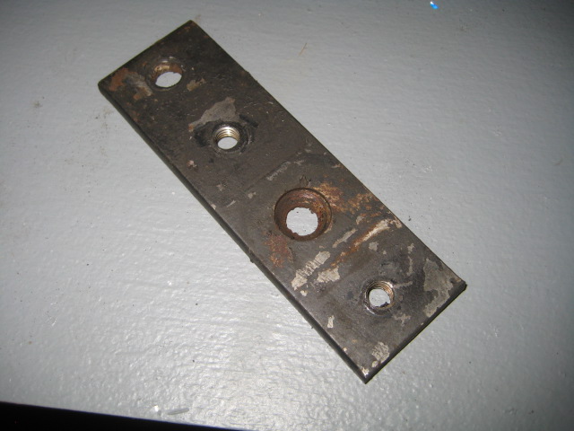

Anyone have a picture of what the Sonoran Steel Rear Sway Bar Adjustment Brackets look like?
Also, do they make a difference? If not, what are some other options?

I'd just get some front sway bar links from a 3rd gen or rear sway bar links from a 2nd gen. Probably a lot cheaper and do the same thing.
I've got some out in the garage, I'll take a pic when I get a chance.
All they do is re-locate the D-brackets higher up on the axle so you can use your stock end links. Simple, but they do the trick.
I didn't see them on the website.
Steve has me just about sold on them, but I'd like to see them before I buy them.
Thanks in advance white_n_slow!

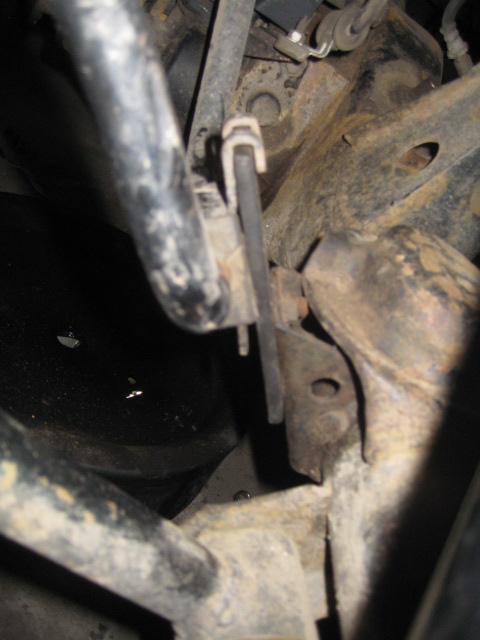

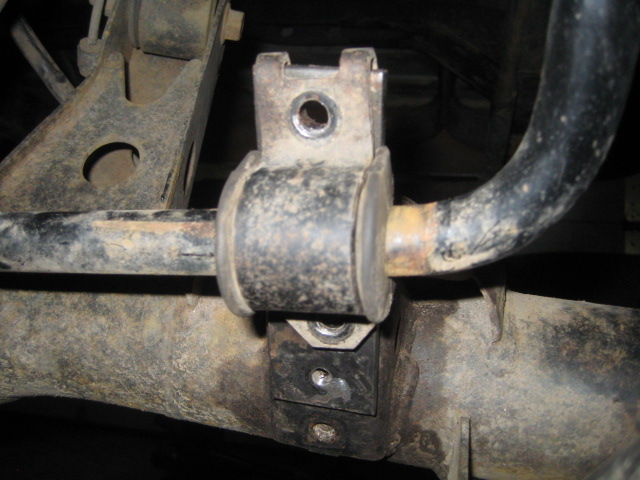

So the idea is the bottom holes (actually the bottom hole and the 3rd from bottom) bolt to your stock D-bracket mount holes on the axle, and then the D-bracket mounts to the upper holes (top hole and 3rd from top) instead of the stock location. It's not actually bolted up in these pics, I just sorta threw it together to give you the idea.
:edit: after looking at the pics, it doesn't actually sit that high when properly installed, about 1" lower. I had it flipped around upside down.
