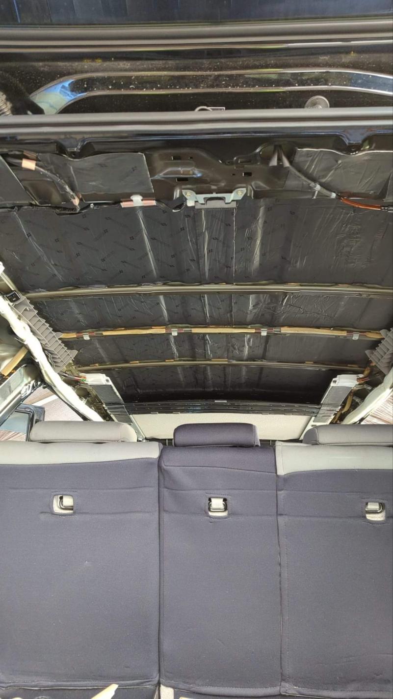

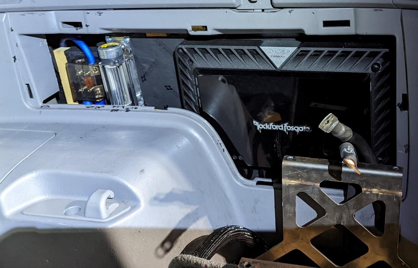

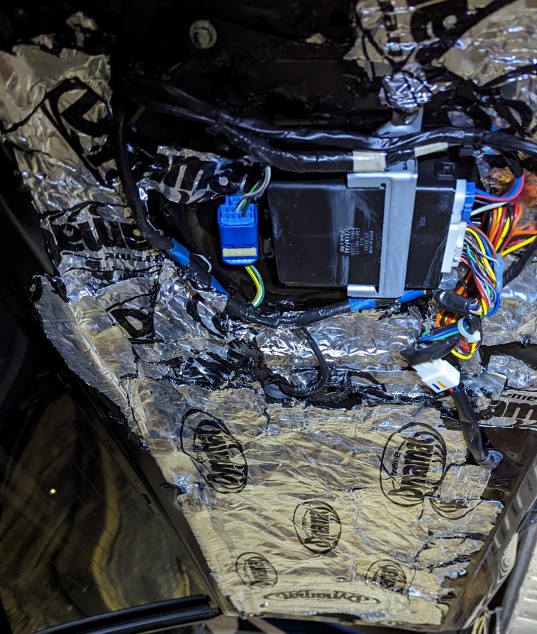

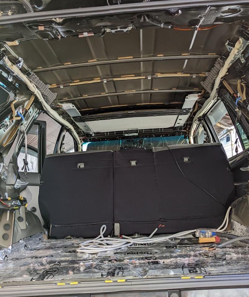

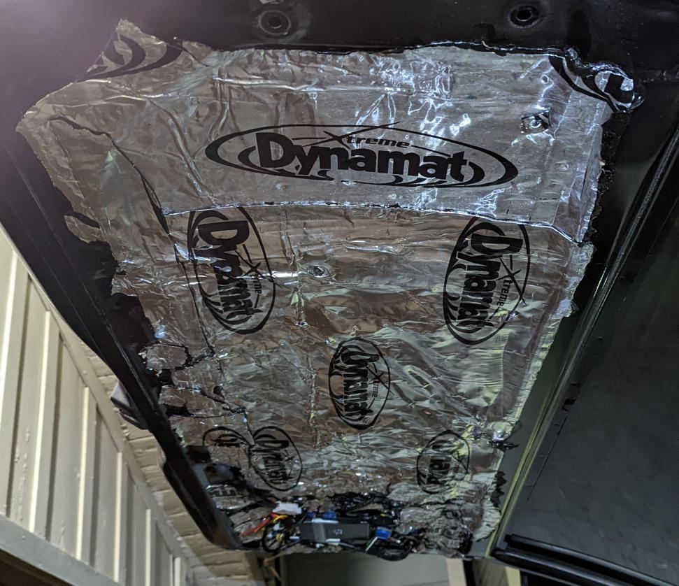

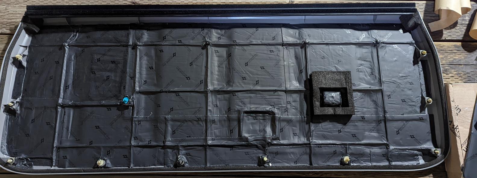

just did mines yesterday. old dynamat still holding strong, decided to add another layer on the cargo floor, exhaust is much quieter now, so much work since i was doing other things at the same time.
also a view of my rear amp rack, never got an updated picture of it since i changed it last year.
