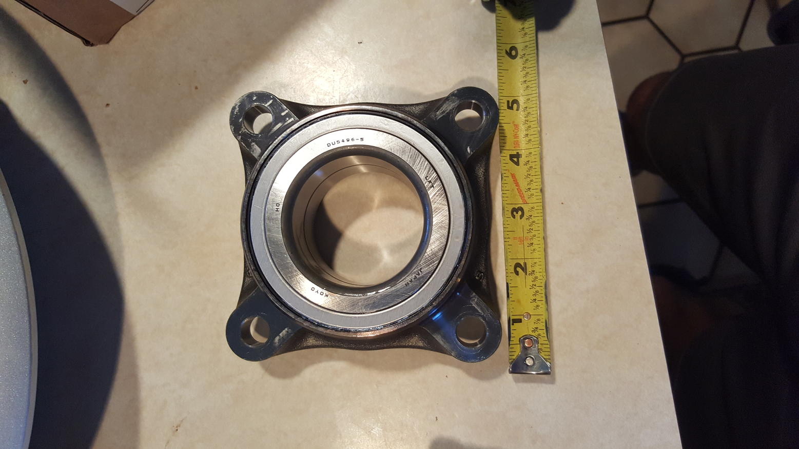

Holy bajjeevus, these bearings are freaking hefty!!!! Can't wait to tear into this project tomorrow. :frog:
Sorry for the mondo picture!!
