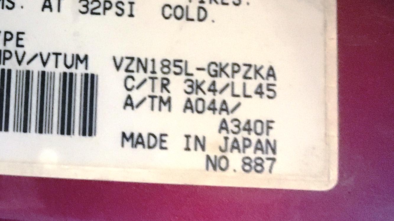

Well a costly trip wheeling leaves me with a grenade-ed rear end. Of course I have a rare A04A axle code so I'm asking for help. I need to find if possible a used e-locker equipped 2-pinion 4.56 ratio 3rd member. Needle in a haystack I guess.... any help is appreciated.
I'll get pics of the diff internals this weekend. Gotta say these 4Runners are built tough. I had to limp over 40 miles after I sheered the first tooth. It made horrific sounds as it ate itself but it never stopped rolling and let me limp to cell coverage. I did detach the rear driveline to limit stress on the broken diff. Ugh!

Doing additional research is it really a 4.56? I'm seeing A04A as a 4.30 in other docs? I would do a spin-test but the diff is almost locked up.
Anyone know axle ratios for sure? It is a 97, Auto, V6, Limited, E-locker, from Canada.

Only sure way is to count the teeth, BUT, for a '97 Auto V6 Limited with E-Locker... chances are likely that it's got 4.30 gears.
I think the 4.56 was only available on I4 Manuals

The only real way to tell ratio is to do the spin test or pull it out and count the (remaining) teeth on the ring and pinion. Toyota was in a weird stage and the diff ratios almost never match your door code.
Typically, all 5 speeds were 4.10, all auto V6's were 4.30 and most auto 4 cyl were 4.56 but this is not a given.

Looks like you all are correct - I've been thinking I was a 4.56 - but this:
http://www.sonoransteel.com/includes...aGearRatio.pdf
I am a 4.30. That makes is so much easier to find parts. I will do the spin test on the front diff just to verify.
