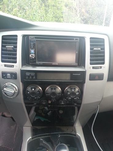

I was looking at your posts and saw that these versions dont come with any sort of traction control, hill descent control or drivers aid like the US versions do which brought up a couple questions. What can my car be missing, can you spot the differences between my rig and yours?

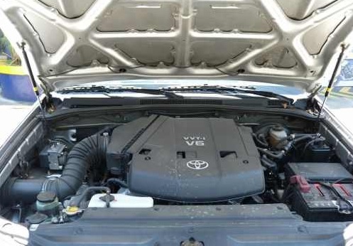

Is my layout under the hood different than the US model? I cant seem to find any real space to actually put in a dual battery system. (See pic)

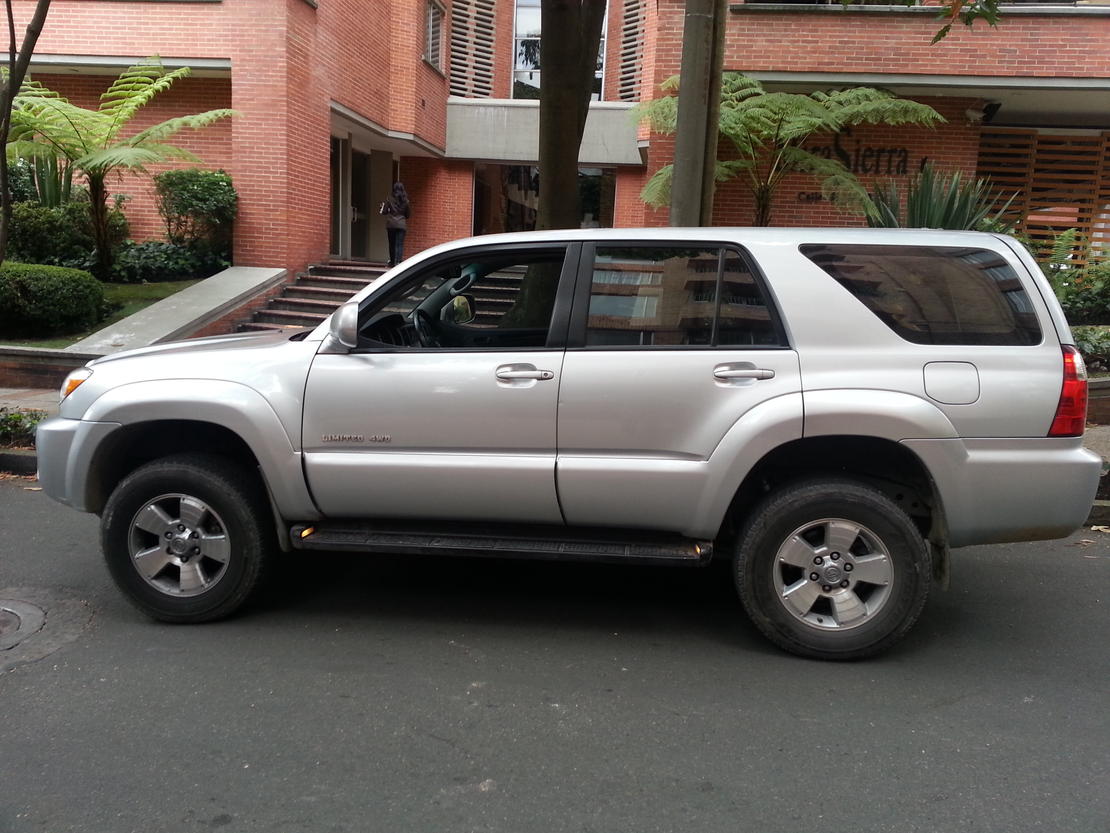

Without me actually looking this information up, I'd guess that your 4Runner is an SR5 with little to no options on it and not actually a Limited.

Your HVAC isn't the same as mine and like you said, you're missing all of the extra features, no roof rack. Do you have cloth or leather? I don't know maybe the dealer that brought that truck in ordered a limited with zero options. I'm not sure if that's possible though.

and yeah, you're missing the hood insulation.

also this limited is missing dual climate control, the A/C 115watt outlet, and I can't tell if it has the heated seats the pictures aren't showing the center console.

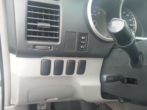

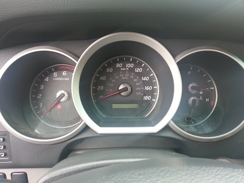

It doesn't have a gauge light dimmer switch either or the ODO/RESET buttons to the left of the gauge cluster. Also showing a manual trip reset button on the right gauge bezel.

My guess is that this 4runner is an SR5 and someone switched the side emblem to 'Limited 4WD' and then sold it as a 'Limited'? Can you do a VIN lookup on Toyota service website and find out what service/maintenance has been done on the truck?

I was thinking this until I saw the memory seat function?! i have an sr5 and while his looks like my interior wise(no dual climate zone) I also have a spoiler and rails. jealous about the seat function though.
edit: he also has lighted running boards(arent those limited specific?) And eventhough I have an sr5 I still dont have all switch blanks on the dash like him? interesante

He's missing the electro-hydraulic booster and has a standard vacuum cylinder. ABS module is by the air intake inlet.
I have the manual trip reset button on the right gauge cluster as well as memory seats.
what do you guys in the US have to look at your trip meters and reset them if not that button on the right cluster? maybe this is a imperial vs metric gauge cluster difference.

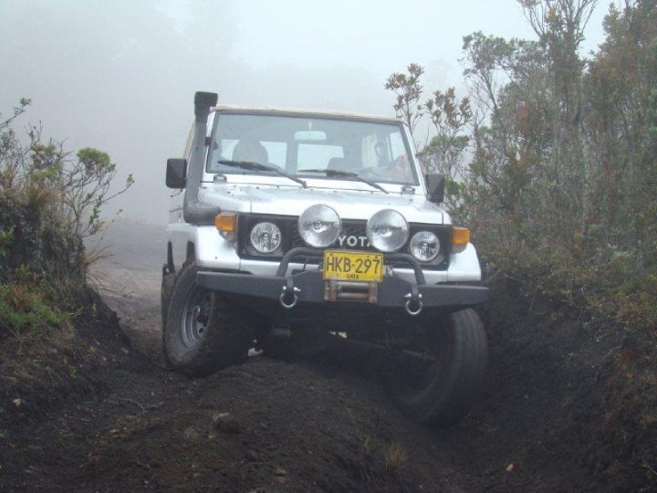

How about the rims, are those the same that were sold in the US? Are my brakes the same as the SR5 brakes? I really want to know to have some 16" rims to swap with my other ride. Here´s a pic of my other Toyota FJ70 from 1986 with quite a bit of mods.

You have the same overall setup that the USA guys have (4 Pot Front Calipers, 1 Pot sliding rear). You're brake booster setup is just different as the assist relies on the vacuum pressure from the engine whereas we have a electric pump and ABS module in one unit (no vacuum boost).
