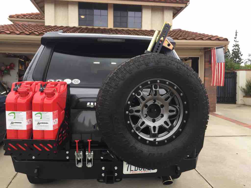

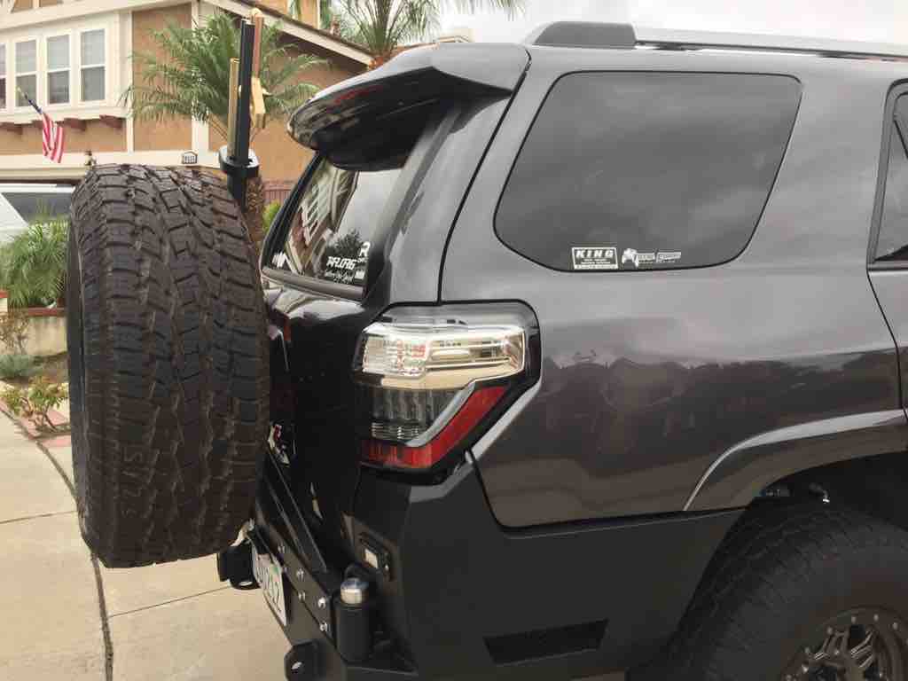

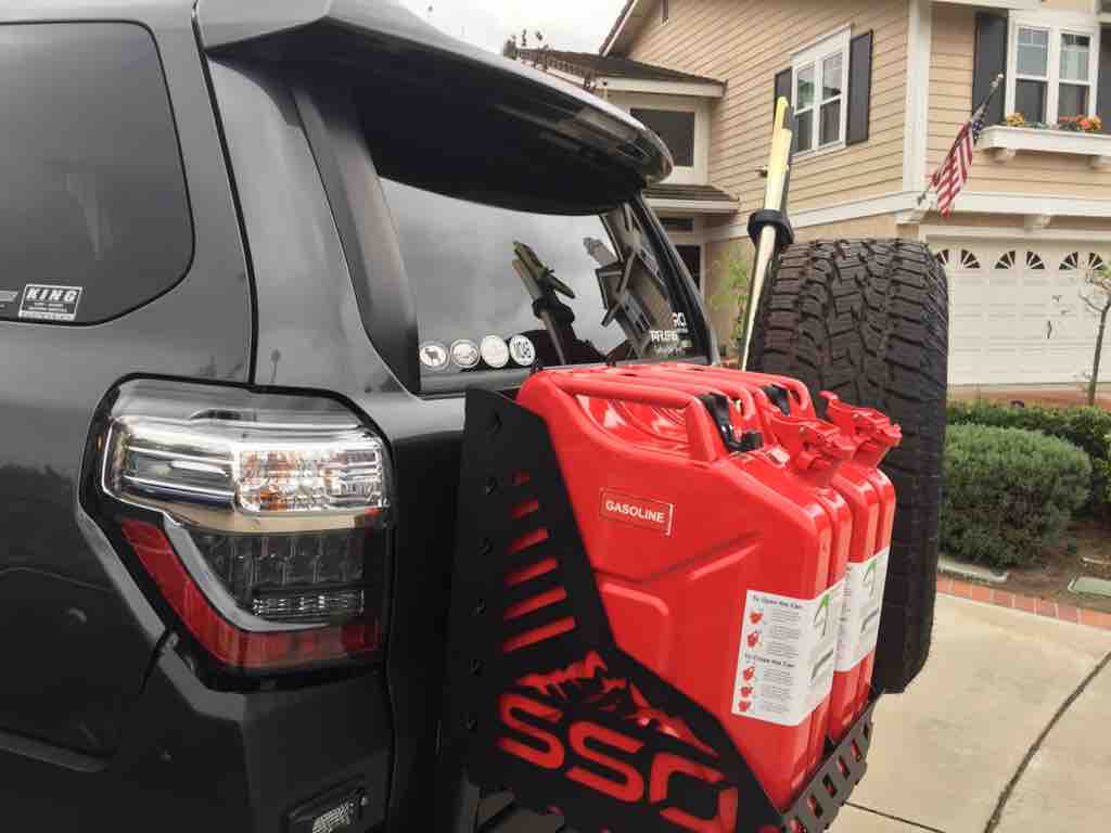

Delayed post after install. Still haven't attached ladder. No current need, but the future plan for a rack is set.
During this install, swapped out front and rear springs. Put OME 2895E rear and King 650lb in place of 550lb. Gained an unexpected 1.5" up front just from eliminating sag after bumper and winch install.
Still need to reroute exhaust behind rear tire.
Love the bumper. It will be nice to get the high lift jack out of the back of the truck during trips.
