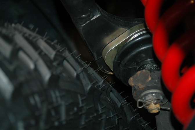

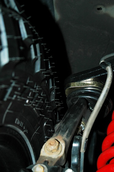

How much space (or lack thereof) is appropriate between your tires and Uca's? The pics aren't the greatest, but as you can see, after installing my Toytec Ultimate and new wheels/tires - I can slide my fingers in between my drivers side Uca and my Nittos...its a bit tighter on the passenger side. Is this something I should be really concerned about? No off-roading here ......

After I installed my lift I had less than a fingers worth of clearance between my tires and the UCAs. I did some light offroading and did not have any rubbing. My lift is a SAW coilovers in front. SAW Coils and Bilstiens in back , tires are 276/65/17 BFG AT kos. I just put on Spidertrax and now I have plenty of room.
