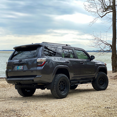

Damn they are skinny though.
255/80R17 isn't all that skinny. Mine isn't lifted yet, no trimming required.
One of the members here runs a 235/80R17, and says it performs great on and off road, and tows often with it. He used to run 285/75R17, and prefers the skinnies.
