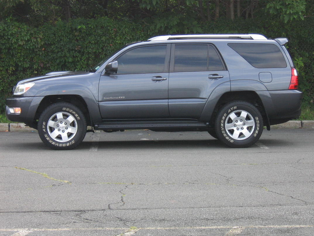

Here's a picture of my 4Runner with a 1" front lift (which is a 1/2" spacer). Notice that there's still some rake, as the rear is a little higher than the front. This is the way I wanted to keep it. I considered going with a 1.25" lift (which is a 5/8" spacer), but I'm fine with just 1".

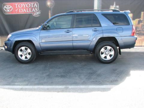

Just for the sake of comparison, here's how my 4Runner looked before the lift (this is not a picture of mine, but the stance was the same):

Huge difference! I'd prefer to get 1.25-1.5 inches of lift, but I've not been able to find a spacer to do that. Everything I've found is either 1 inch or two. Wheelers Off Road shows a Daystar kit that give 1.25, but I've not read good things on their measurements. There's a ton of discussion about whether it's a 1.25 lift or 1.25 spacer. Also, they don't even have that listed on their website, and from what I've read people have no luck at all with their customer service.
