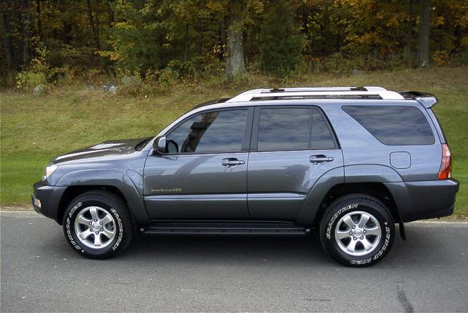

Yes, I'll post a before and after shot. This is a 1/2" spacer, which gave me exactly 1" of lift in the front. It's a Cornfed spacer, BTW.
Before:

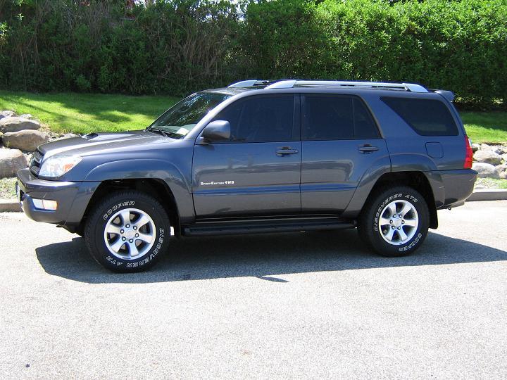

Here's the after shot--- I put new tires on right after I installed the spacer:
After:
Still has a sligth rake, but as you said it looks good! What size are those tires? I'm gonna do some more measuring on the floor boards today, and I'll go from there. Thanks a lot guys, I appreciate the input.
Tires are stock size, 265/65-17
