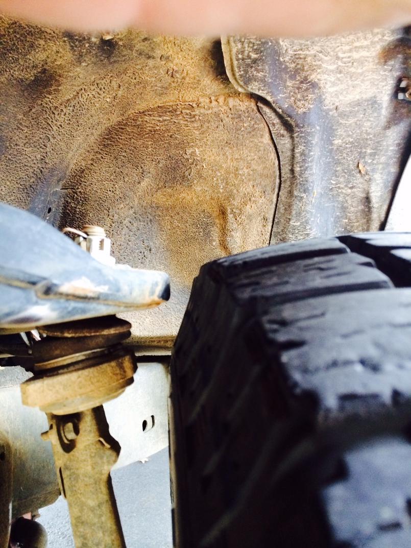

I have a 00 4runner with an ome 3 in lift. I was told that 285/75-16 would fit and they do but I kept the stock rims so my back spacing isn't the best and I have a 1/4 inch maybe between my tire and my UCA. I am looking for spacer help. I am not sure what size i should go with. If anyone can help me with figuring it out please do.

This is it on the lift. So it doesn't rub when I set it on the tires but I don't know how much clearance I have when I hit a small bump of any kind.
Personally I would replace the rims, get aftermarket UCA's or grind the stock UCA's down before running spacers.
Your correct but I don't have that option right now other then grinding down the UCA. I live on a small island and new rims would run me about 300 in shipping alone. I am only thinking spacer till i transfer out of alaska but with that being said the speed limit here is 35 so spacer aren't probably and issue for the next 2 years till I move. I have only put 400 mile on the car in the 8 months i owned it. I can't wait for new rims and UCA.
Discount Tire Direct has free shipping on everything, and all the time is you want new wheels. Pick up some 1-1/4 spacer and you'll be fine. You'll need to get HUBCENTRIC spacers, and nothing but HUBCENTRIC.
It looks like the tire rubs pretty good at full droop.
SpiderTrax Spacers 1.25 inch ones is what I would recommend, outside of different wheels or a new UCA. They are about $100 for a pair and to make the front and back match you would obviously need two pairs. No idea about shipping to where you are at. Also if you search the forums you can typically find a used pair for cheaper.

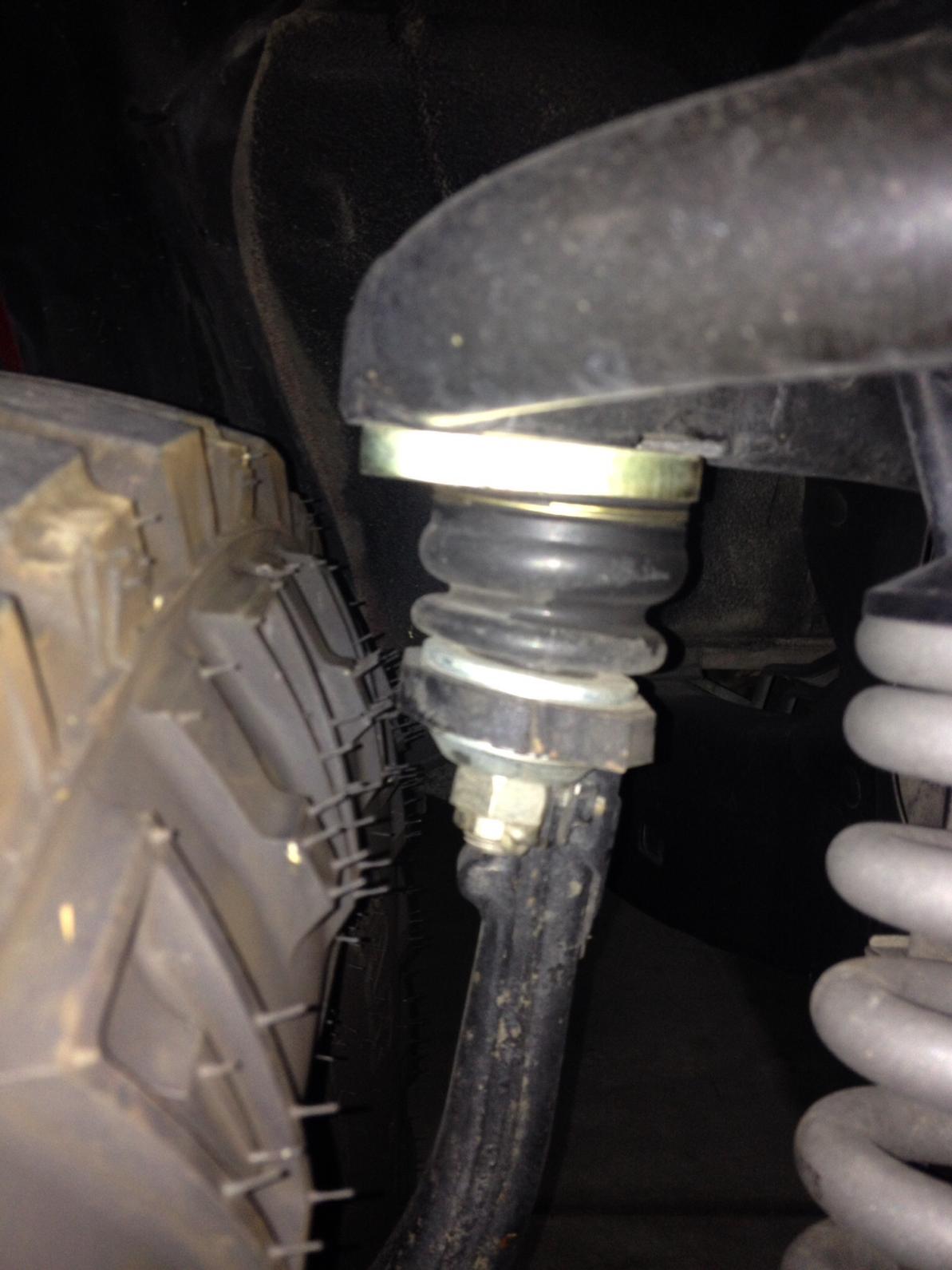

I have the light racing UCA's, 285/75/16 and oem 5 spoke wheels. This is what mine looks like.

I switched to a 1.25 hub-centric spacer as well so I could run my new Toyo 295/70's. I'll be curious how much cutting you have to do to get rid of rub. I had to dice my front inner fender and trim up about 6 inches, and grind down the pinch weld at the lower rear of the well. Happy with the results though!
