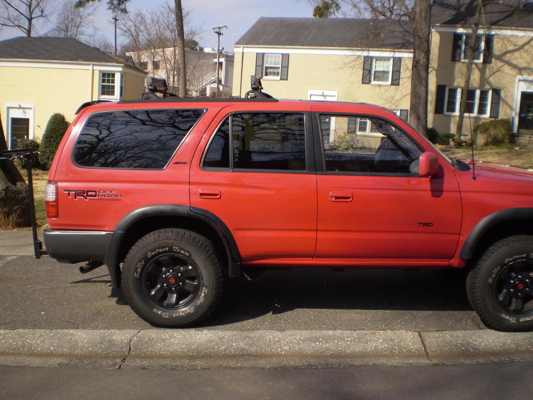

I want to put a 2" spacer in the back to help out on my rear sag situation, I really don't offroad hard, just going snowboarding and mountain bikeing. How big of a spacer can I use before I have to go to longer shocks? Does anyone want to sell some ole spacers ya got laying around...I know you tried it before you wanted some Real flex...lol Thanks guys, this is my first real post.

The rear sag isn't real bad, and the ride is ok, thats y I was thinking of just spacer. What ya think?
I still think spacers are going to finish off those saggy coils and kill what ride quality you have left. New coils are about $170/pair. A pair of spacers aren't much less than that new so I personally would not think twice about it. If you want some used 2.5" rear spacers PM me, I have some and would sell them for cheap, but I still recommend new coils for you
