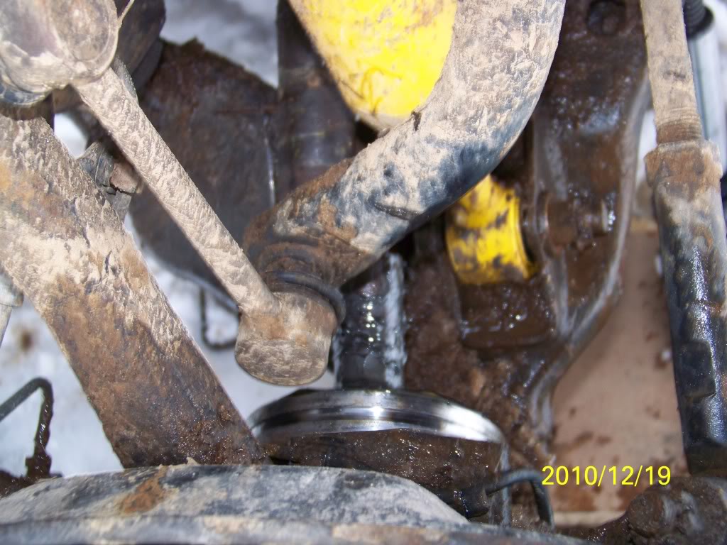

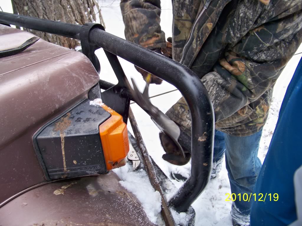

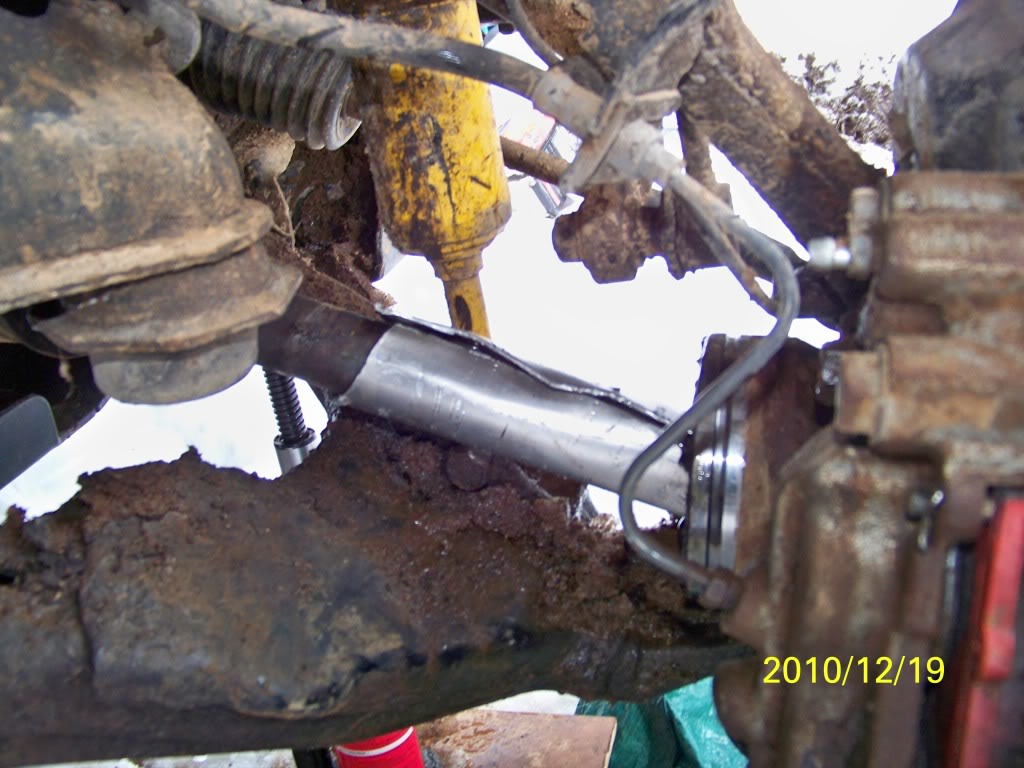

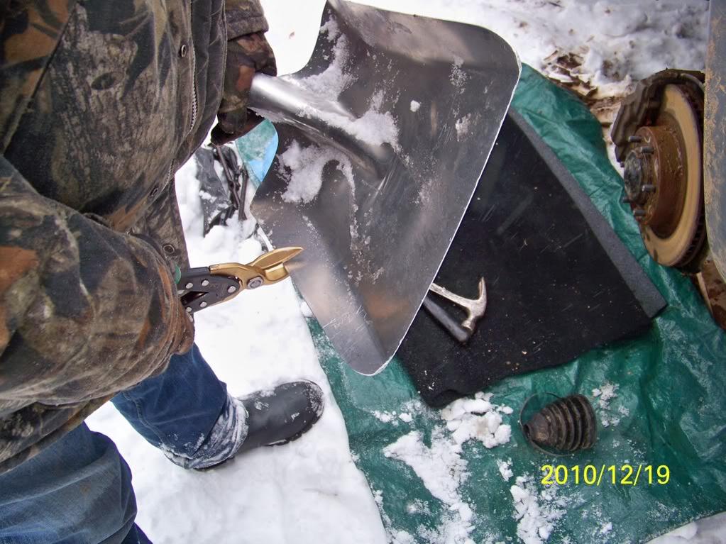

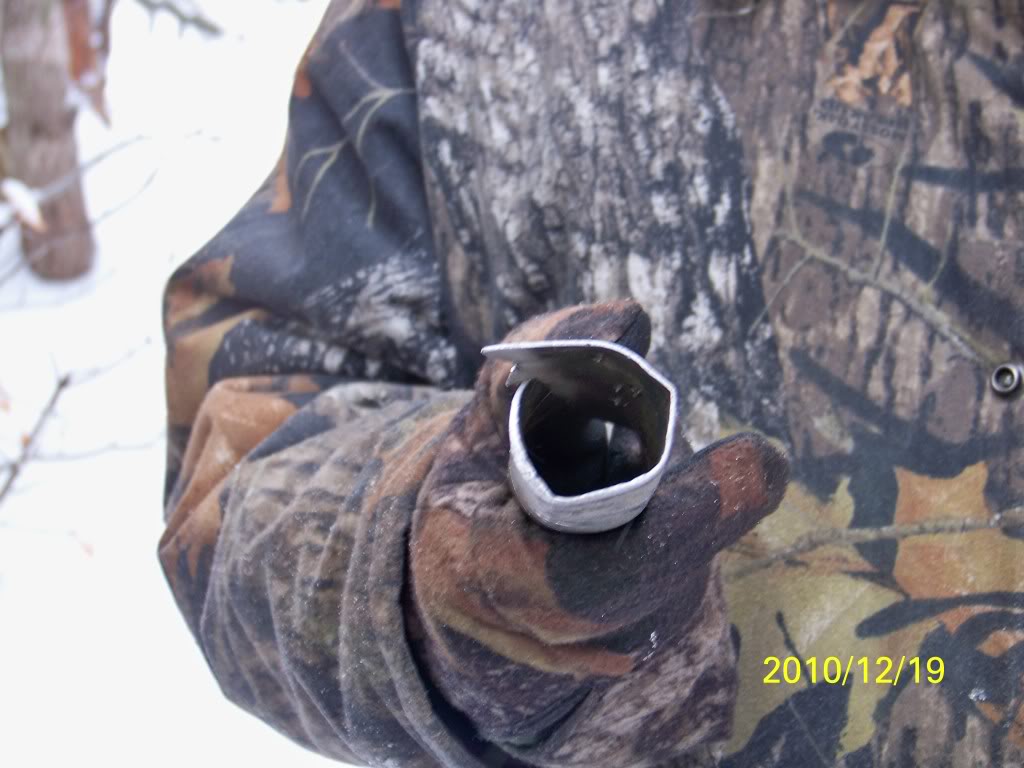

This is how we fixed a broken passenger axle on my 4th Gen V8, therefore 4x4 always on....Well more like patched it up to get me out of the woods, the snow, and the cold. I also had my wife with my 2 year old girl in the back seat which was stressing me out.
Secured the truck. Removed the wheel. Took an aluminium shovel. Cut out a piece. Bent it round like a cylinder. Fit it over the axle. Tied and secured it in place with steel wire.
This prevented it from flinging all around when I drove out of the forest.
