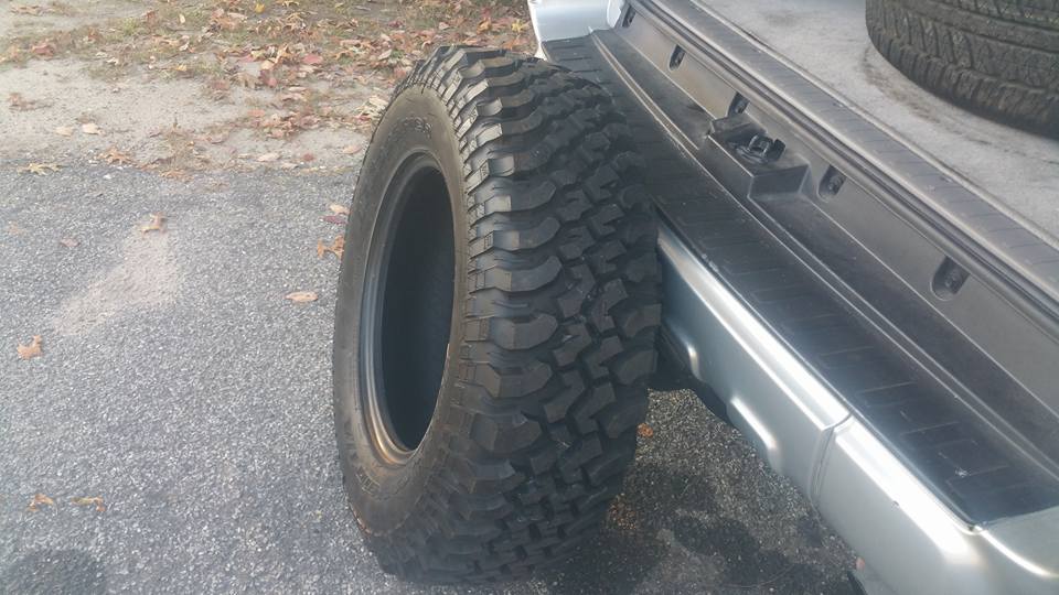

Problem solved.. Found a spare in time for my trip this weekend. 100 bucks on craigslist never been used.
Thanks for the replies though.
This is another one of those misleading things, you can do a search and get completely different answers. obviously the safest approach is to get the correct size spare but in a pinch, would a inch or two Actually make a difference for a short period of time. again, ive heard 10 different theories. Im sure one day someone may want to know the real answer with an explanation

Glad you found a similar sized tire. That's your best option. I've never heard of someone running for such a short distance (<100 miles) at low speed and doing damage by having a slightly smaller or bigger tire. We have open diffs. Maybe the stability control would act up, but I would think not. Plenty of cars use donut spares significantly smaller than the factory tire size. My bigger concern would be getting off the trail with a puny shoe on one foot. :)
There are a lot of those. I'm happy with the hard won answers I've gotten for myself on various subjects but often there's no reward trying to share them -- unless arguing is considered its own reward.
For the record, I wouldn't hesitate to do what you asked about (50-100 miles out of the woods).
