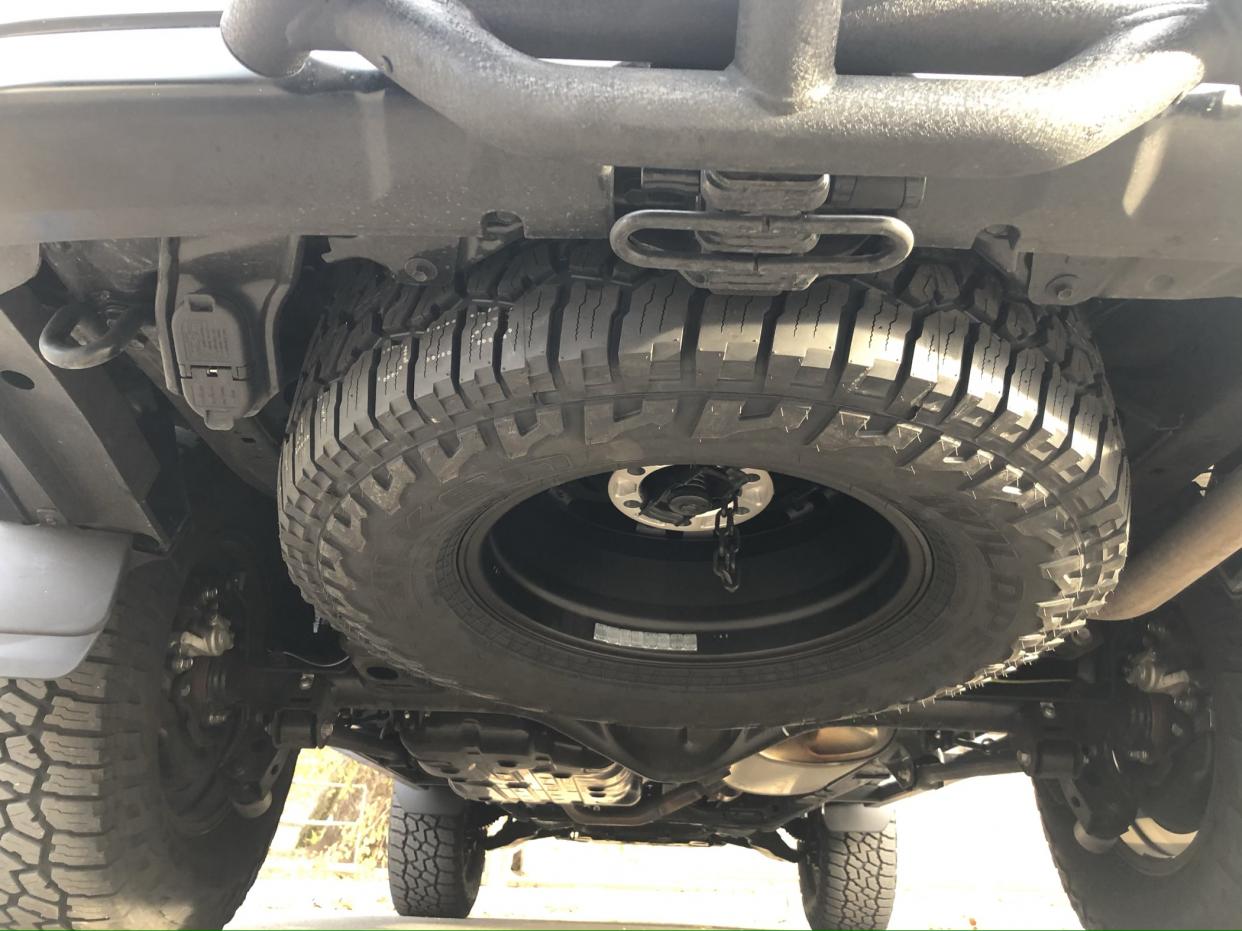

I have used search and understand that a 285 tire will fit under the 4Runner. I am skeptical about this as my OEM spare tire is almost flush with the edge and it looks like there is no room.
I just bought a new set of BF Goodrich All Terrain T/A KO2 LT265's and have an extra one I would like to use as a spare. My question is should I mount the BF Goodrich All Terrain T/A KO2 on the spare wheel/rim and place it back underneath or should I get another wheel/rim which matches my Trail wheels?
I am curious if it has to be the spare rim or will another wheel work?
Yeah , ran a ko2 285/70/17 on the spare rim for a few years. You get som play with where the wheel sits when the chain has some slack.

I run a 285/70-17 on a matching TRD Pro wheel that fits in the spare tire well fully inflated. The nice side faces upward. I hear from those who have KDSS that it rubs slightly against the bar, but works.

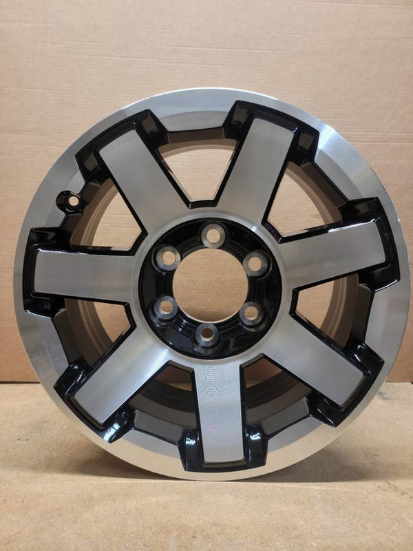

Thank you for all of the information, this is helpful. I assume the trail wheel is lighter then the spare wheel and just better all around? I want to use this as the spare wheel:

the standard trail wheel will work. many have a fifth TRD pro, trail or standard rim as their spare rather than the steelie. limited have a full size spare as well so it will work. I have 265s on an 8" wide rim and it fits just fine and I think the trails are 7.5" wide so you should have no issues
It will fit, but the trail wheel is much heavier than a steelie. I believe it is 31 lbs each. No real benefit vs a steelie for short term use.
